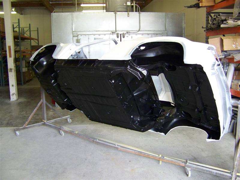

First I painted it with an industrial finish and then did the liner. The engine bay and fuel tank were also done.

PanelBilly And the bed liners are very light. If your looking... Sep 29 2013, 09:44 PM

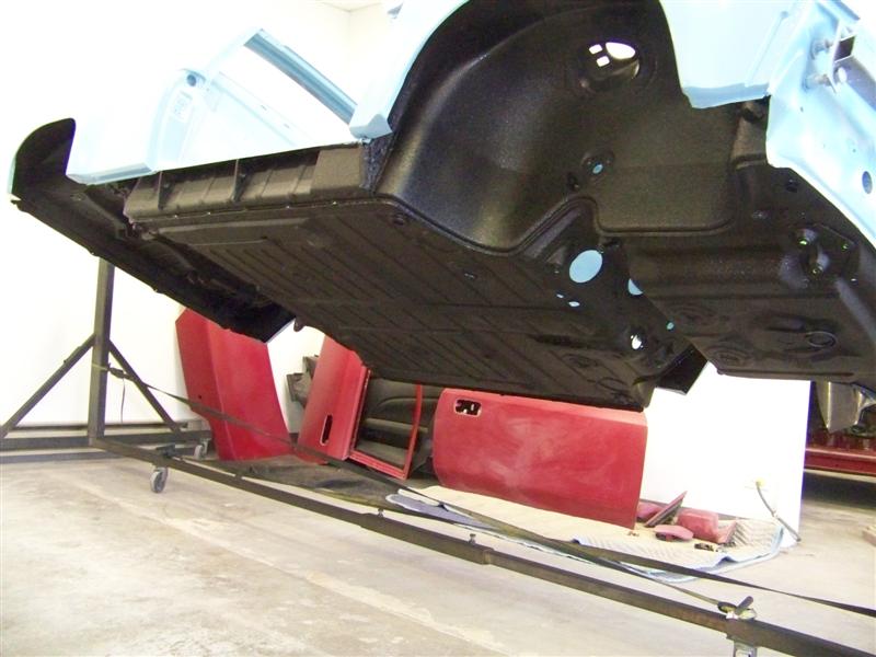

jaxdream The 73 tub I got was from a guy that run a Rino Li... Sep 30 2013, 10:53 AM
mrbubblehead panelbilly, do you have a link to your thread?
ja... Sep 30 2013, 06:13 PM
boogie_man It's a lot of work but I felt it was very much... Sep 30 2013, 06:46 PM
mrbubblehead woah! i like that scott. i like the way you pa... Sep 30 2013, 07:19 PM
