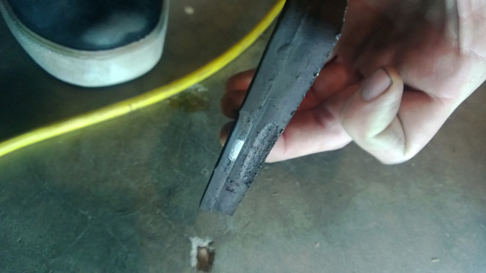

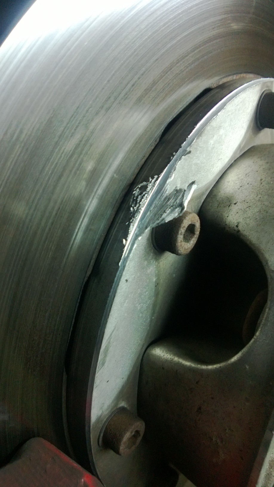

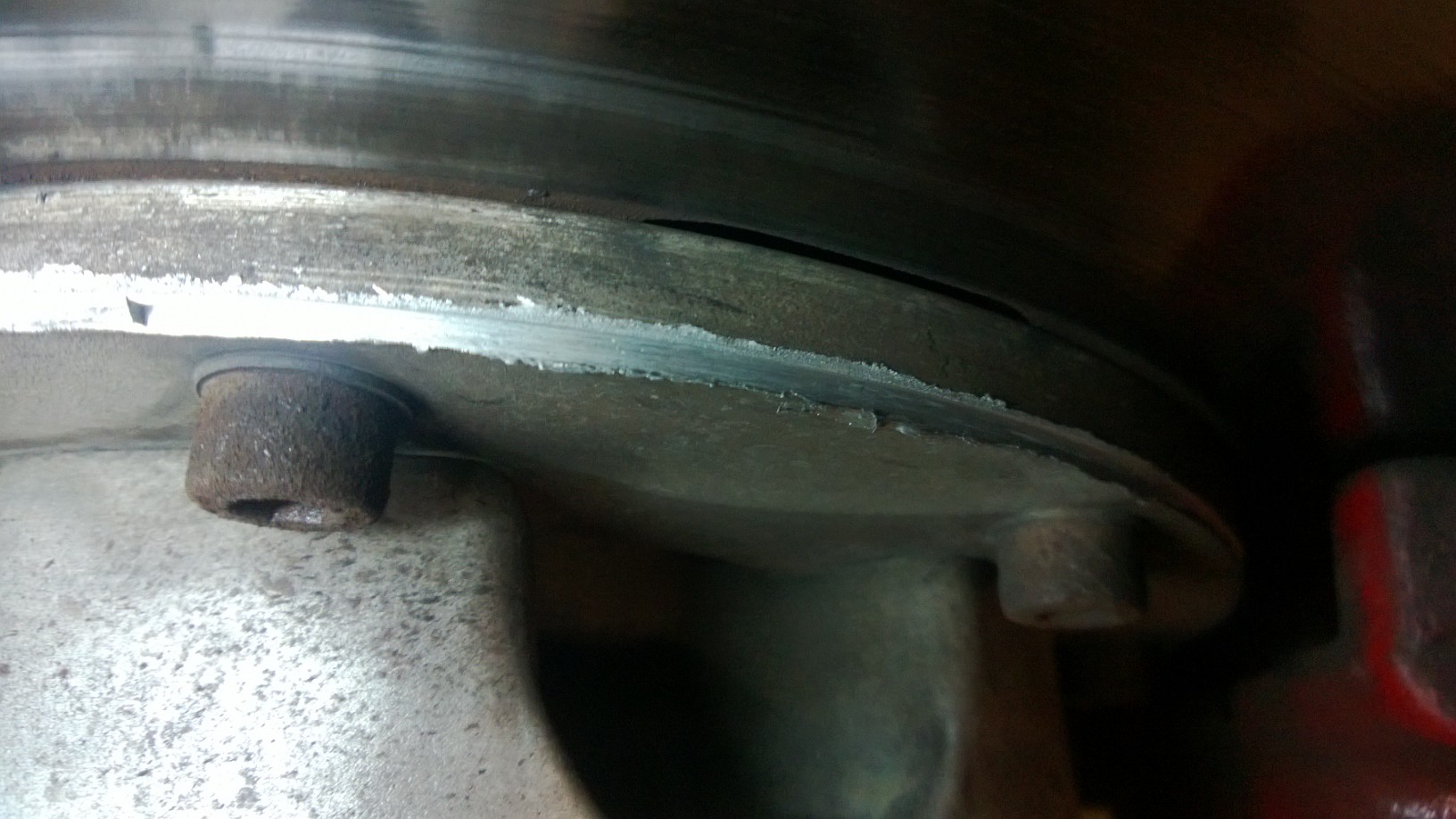

For my 1000'th post, I have attached a few shots of the damage to the hub from the brake pad. My plan is to take a grinder to the metal lip and take enough of it so it clears. Anyone see problems with that?

tscrihfield   Ross, That's not the hub...that's the roto...   Oct 1 2013, 07:29 PM
'73-914kid   I'm gonna guess you have the Volvo 4-pot calip...   Oct 1 2013, 08:47 PM
Eric_Shea   That's not the rotor hat either... That's ...   Oct 2 2013, 06:16 PM
rnellums   Maybe these photos will make it clearer. I'm ...   Oct 2 2013, 07:30 PM
tscrihfield   Those are some sort of hat... Doesn't look as...   Oct 2 2013, 08:45 PM
