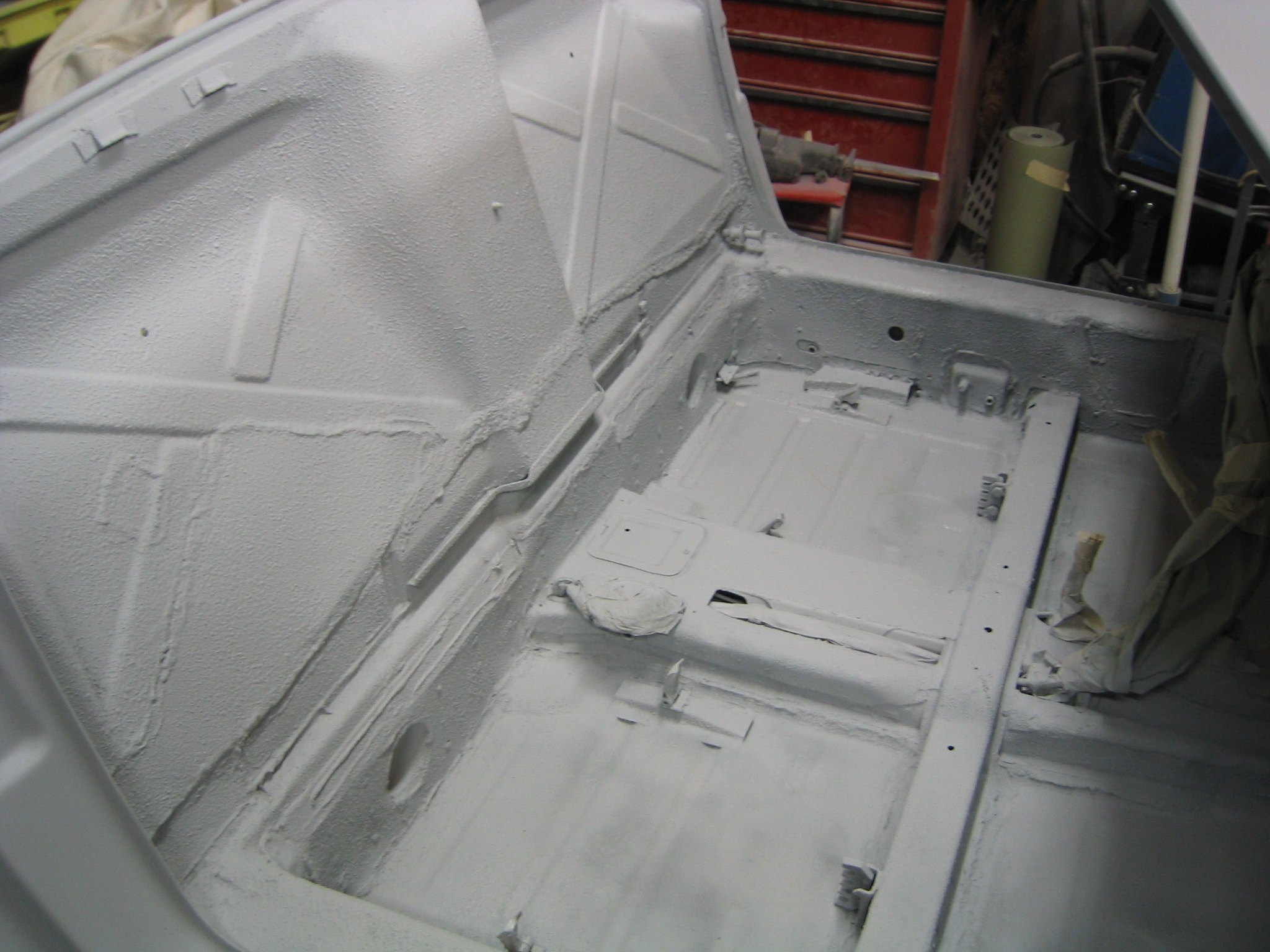

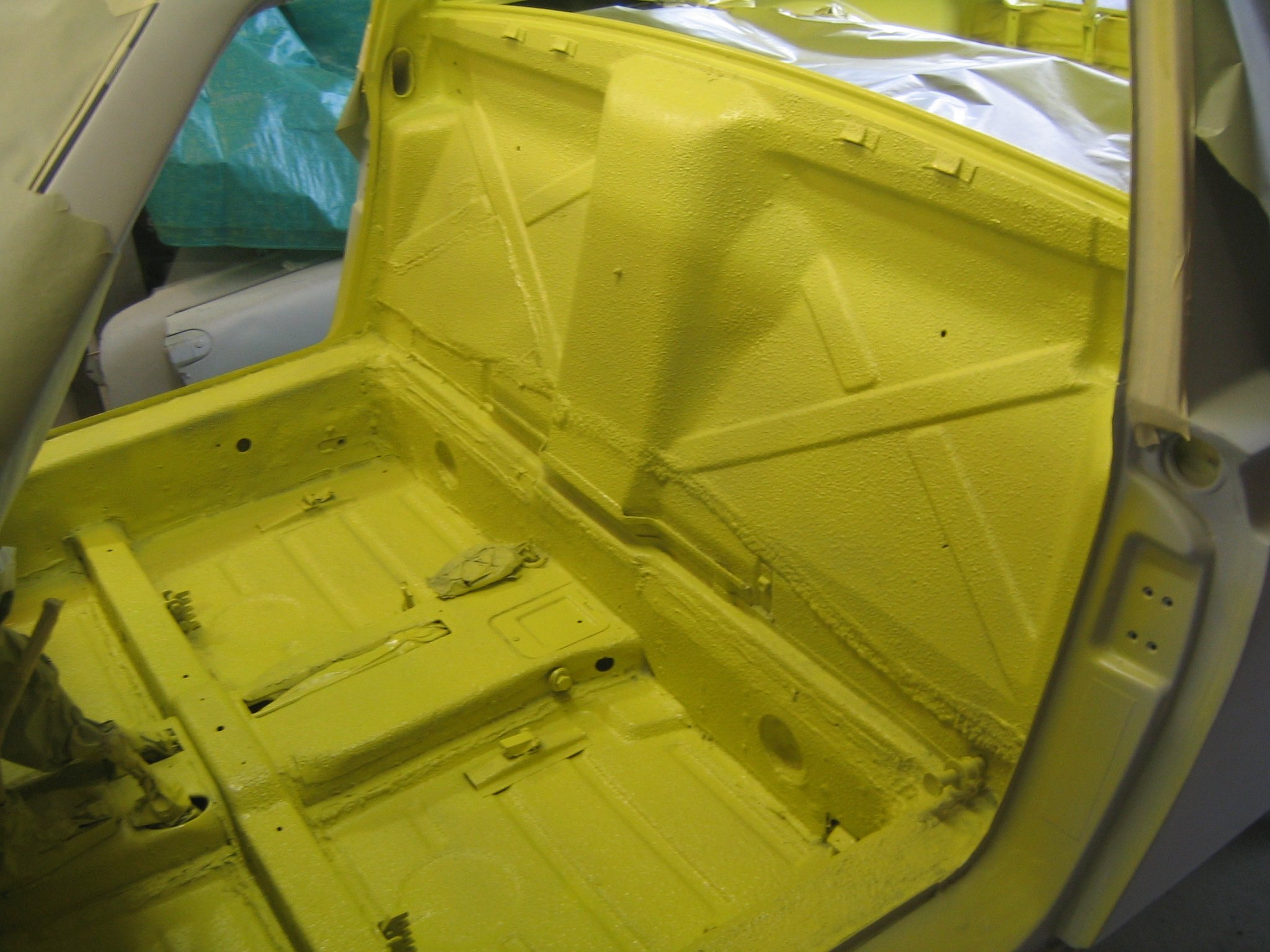

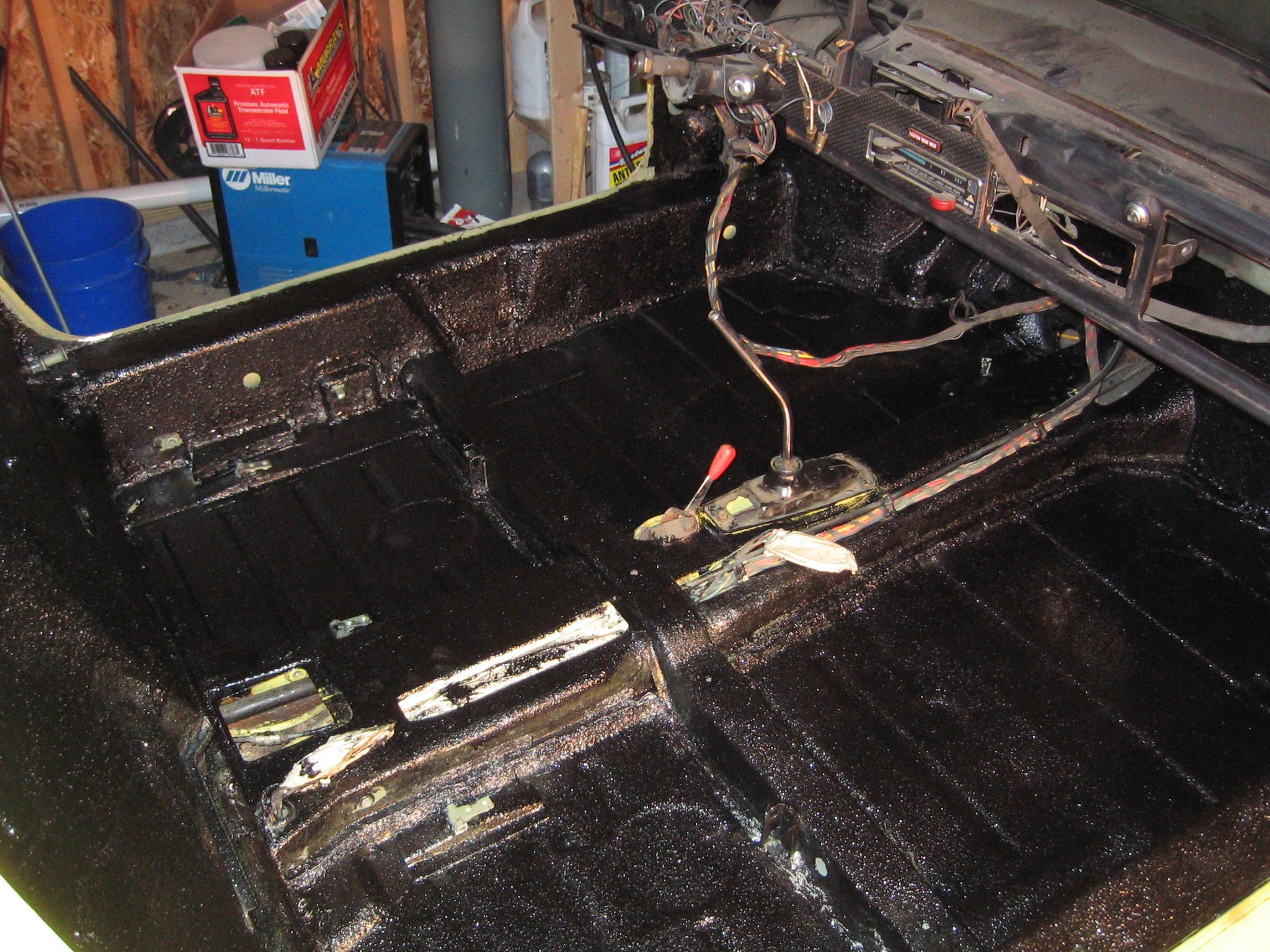

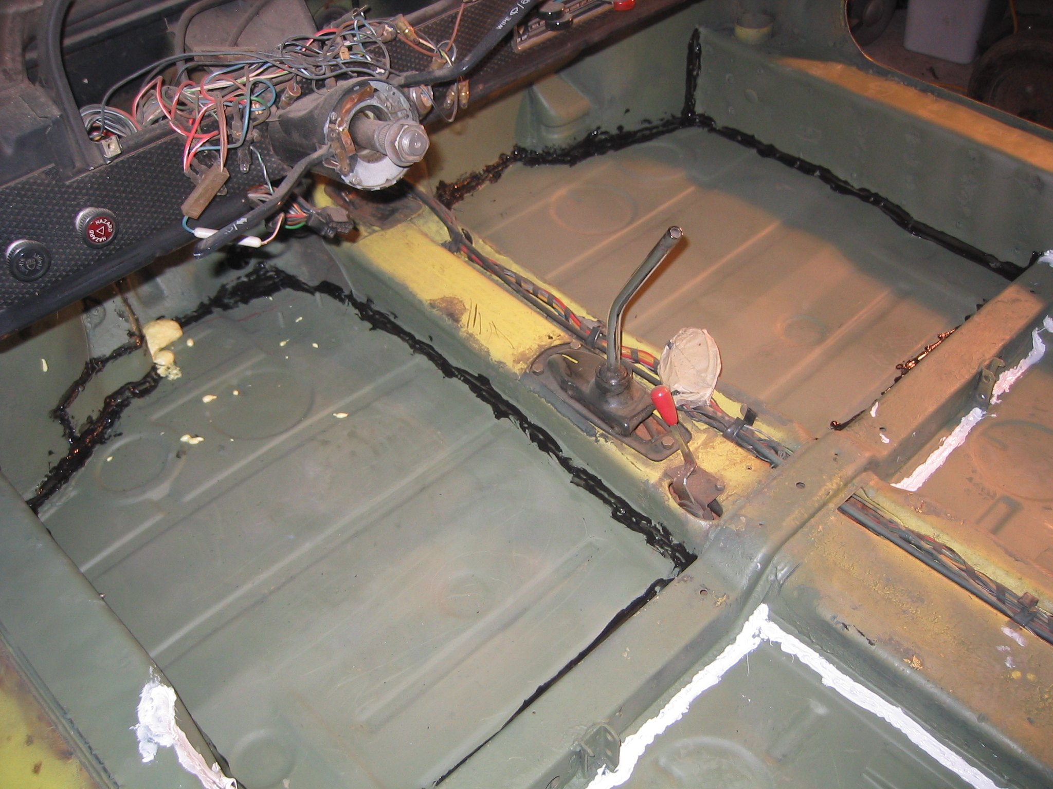

FWIW, here's how I did the interior of my 73. I imagine it would work well for the undercarriage too.
I used rattle-can etching primer, then seam sealer, then Herculiner, then 2k primer, then paint. The Herculiner went on a lot thinner than typical "RhinoLiner" and was only $60 a gallon at the time. The pail weighed about 7lb full, so to doesn't really add that much weight to the car. If I had to do it over again, I'd skip the seam sealer and just cake the Herculiner in there. Others may disagree with this though. Here's a few pics of the process I used. Again, I might skip the seam-sealer next time. Although, it's encased in 3 coats of rubber Herculiner, and primer, and paint...so maybe it'd be ok. Attached thumbnail(s) |
