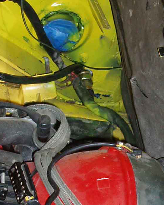

I am looking for a picture or diagram on how to route the aftermarket oil line from the engine block to the tank. The output for the tank is above the Tins and the one for the motor is under. How do I bring it down from the tank? Tank is at stock location.

You need to drill a hole in the engine shelf and run it under the front of the engine along the fire wall and to the side of the engine! You can not use the factory hard 6 oil line with that front engine mount so you need to make one!
I don't know if you can see it in this photo!!
