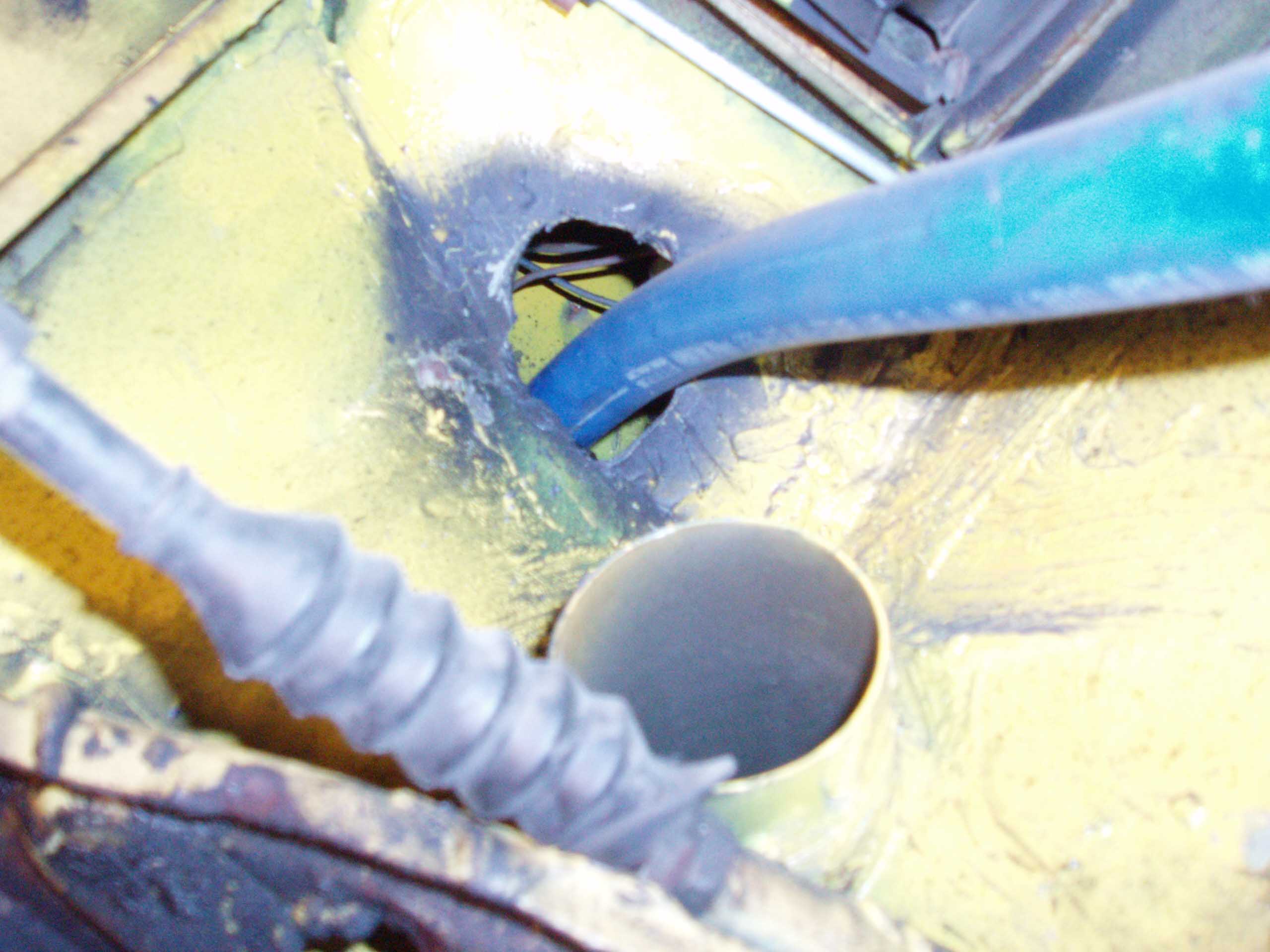

I am looking for a picture or diagram on how to route the aftermarket oil line from the engine block to the tank. The output for the tank is above the Tins and the one for the motor is under. How do I bring it down from the tank? Tank is at stock location.

You just need to drill the hole large enough to get the fitting through! It is straight across from where it attaches! Make it as low as you can so it won't chaife on the edges when you turn it down to go under the engine mount!
Mine is kind of large because I had a rust spot that I just cut out!
