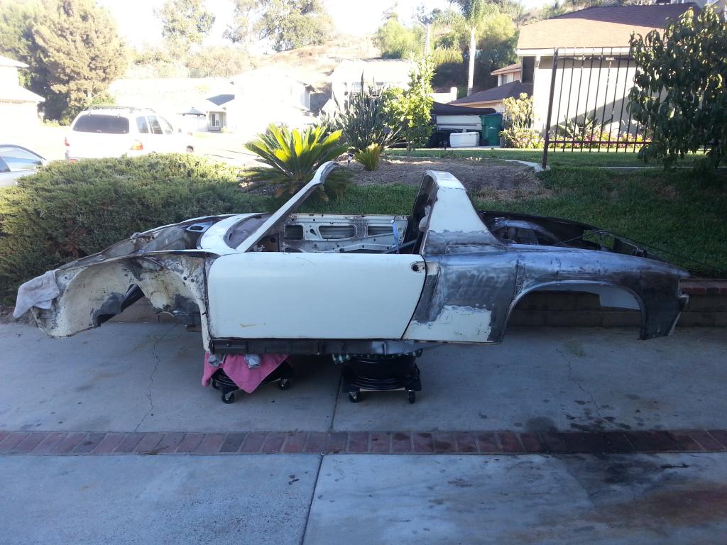

I have the axles for the G-50, will they work with the G-466 ?
Getting the thing blasted soon, Who do you guys use ?
(IMG:http://www.914world.com/bbs2/uploads_offsite/i60.photobucket.com-3782-1380777114.1.jpg)
