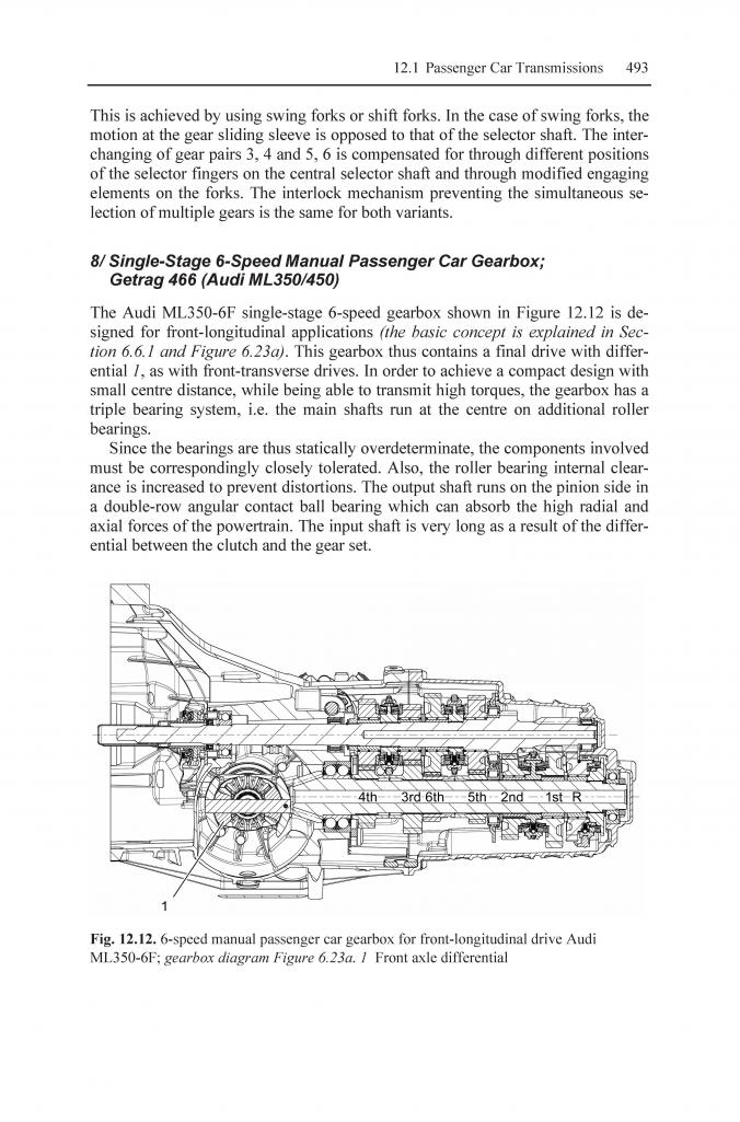

I don't personally care which transmission you decide on. Here is some info on the G-466. This is the same tranny that is used in the AWD platform too. It must be able to handle some torque...
