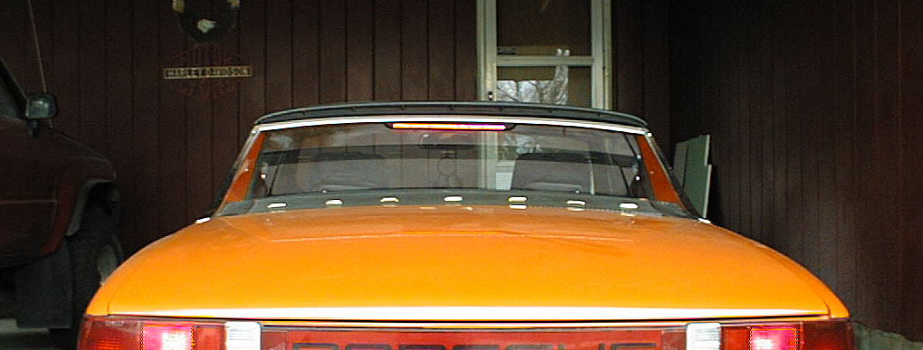

> 3rd Brake Lamp, my best try..., Now bigger and better! 2019
Garland
post Apr 9 2005, 10:20 PM
Restoration Fanatic
Posts: 1,438
Joined: 8-January 04
From: ......Michigan......
Member No.: 1,535
Well can you see it?

Aaron Cox   pretty cool... wheer did you put the wires>?   Apr 9 2005, 10:27 PM
Garland   A little closer look.   Apr 9 2005, 10:38 PM
Garland   Wires are inside the stock roll bar. Then behind t...   Apr 9 2005, 10:40 PM
Garland   Cut the hole in the trim to fit the face of the la...   Apr 9 2005, 10:44 PM
Garland   Light on   Apr 9 2005, 10:46 PM
Garland   DOT approved lamp, brightest light on the car.   Apr 9 2005, 10:48 PM
Garland   Top off.   Apr 9 2005, 10:50 PM
Garland   Again flush, almost with trim. Did not want to hav...   Apr 9 2005, 10:53 PM
Garland   This picture just was cool.   Apr 9 2005, 10:54 PM

Garland   You can just see it at the top of the rear glass. ...   Apr 9 2005, 11:14 PM
Garland   Ford GT   Apr 9 2005, 11:16 PM
Andyrew   How the heck did you get that part??? How much?? ...   Apr 9 2005, 11:18 PM
Garland   <...   Apr 9 2005, 11:22 PM

Garland   The trim needs to be cut out of the top 2/3 for th...   Aug 21 2005, 10:41 PM
Garland   This shot shows the trim bar upside down. Notice t...   Aug 21 2005, 10:42 PM
Garland   This is from the back side of the trim. The black ...   Aug 21 2005, 10:43 PM
Garland   Another view of the backside.   Aug 21 2005, 10:43 PM
Garland   The wiring comes out the back of the lamp through ...   Aug 21 2005, 10:44 PM
Garland   Down the sail behind the sail trim,   Aug 21 2005, 10:44 PM
Garland   and between the left grill end piece,   Aug 21 2005, 10:45 PM
Garland   into the trunk. Along the left side wiring harness...   Aug 21 2005, 10:46 PM
Garland   I hope that will help anyone doing this 3rd brake ...   Aug 21 2005, 10:47 PM
