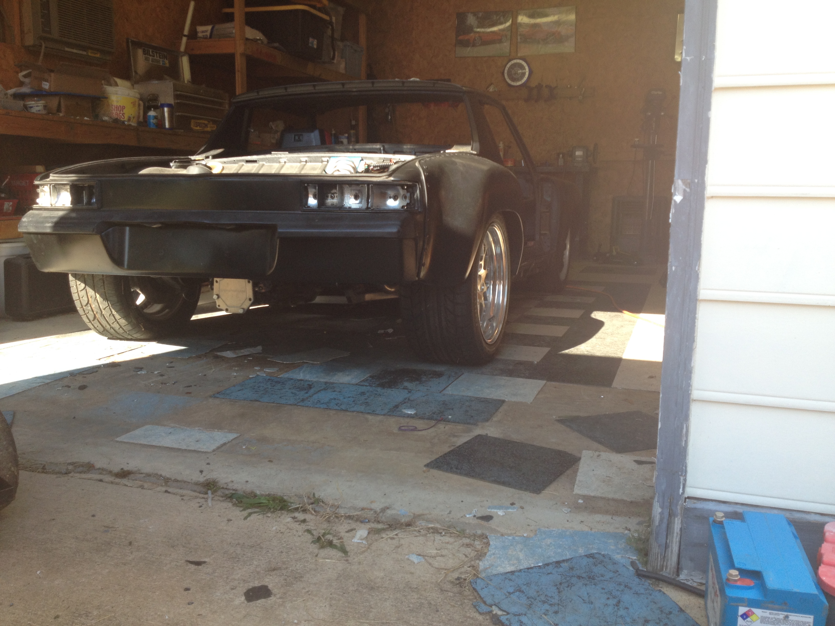

Finally on the ground and headed home for finishing.. Bob, Bigkat ,has been a great help.. Now back to my little garage for some late nights and long weekends to finish..

d914   New shocks,, Rebel racing tops, UB Machine bottom....   Oct 6 2013, 12:02 PM
d914   Finally on the ground and headed home for finishi...   Oct 6 2013, 12:06 PM
d914   Still needs to be adjusted.. a bit lop sided.... ...   Oct 6 2013, 12:07 PM
d914   we tried on one of Bob's 17x10's on my car...   Oct 6 2013, 12:09 PM
d914   these will be going on.. 17x9 , 17x8..   Oct 6 2013, 12:13 PM
