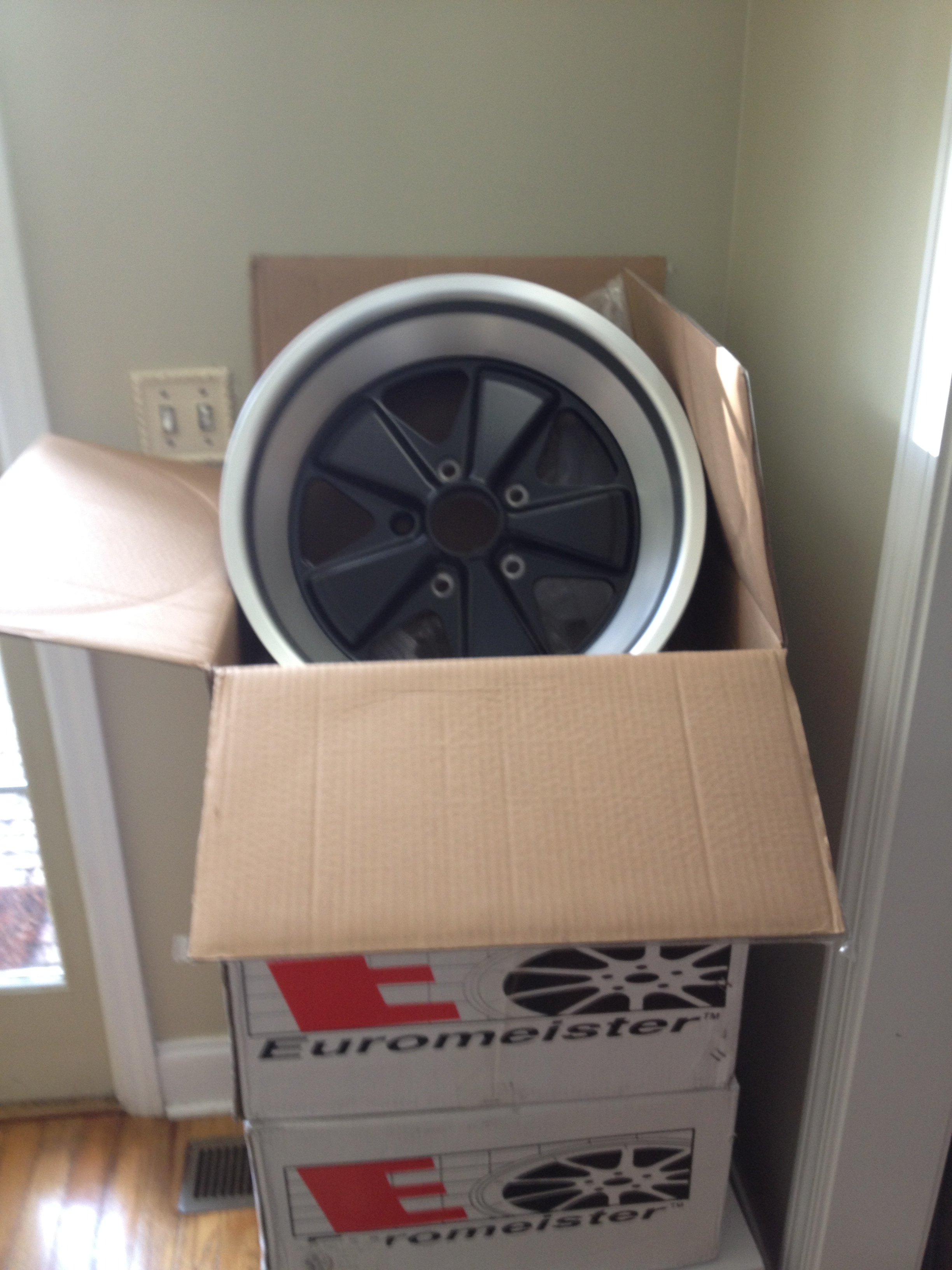

d914   we tried on one of Bob's 17x10's on my car...   Oct 6 2013, 12:09 PM
d914   these will be going on.. 17x9 , 17x8..   Oct 6 2013, 12:13 PM
