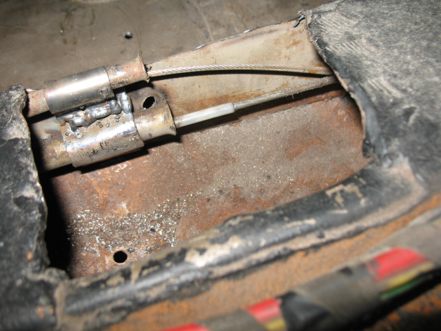

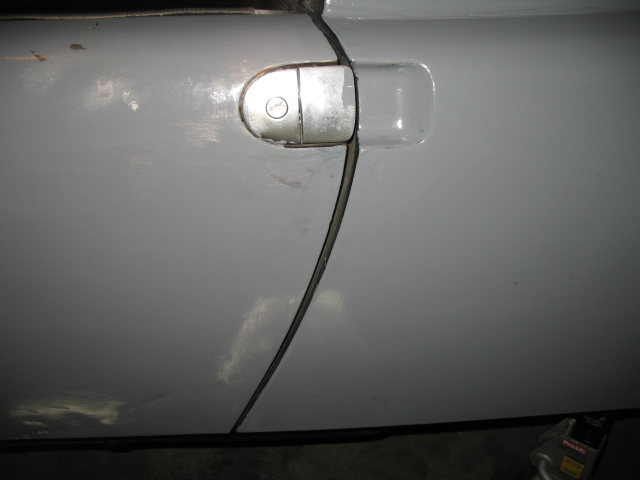

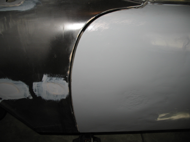

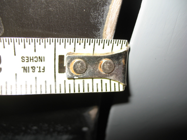

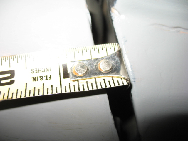

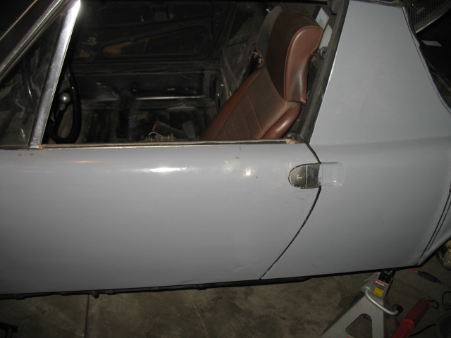

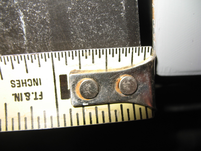

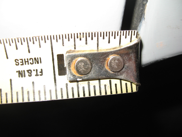

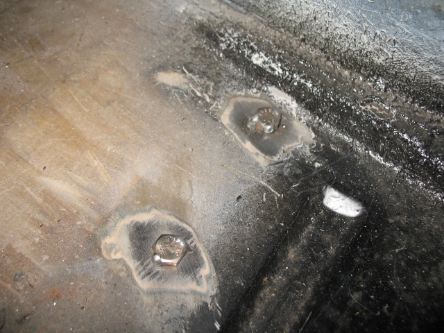

well, my car had a big gap, at top, between the drivers side door and the rear fender. I've been thinking of using a cut off wheel and cutting around the long, top and both sides, letting car settle into the gap, and welding the seam back up. but today I decided to add few washers to the door hinge as a less invasive approach. prior to today, door had to be slammed BRUTALLY HARD to close, but after washer treatment, 2 at top and 1 at bottom, and door closes nicely now. good enough for me.
next step is add coolant to cooling system, get a battery, and see if she starts.

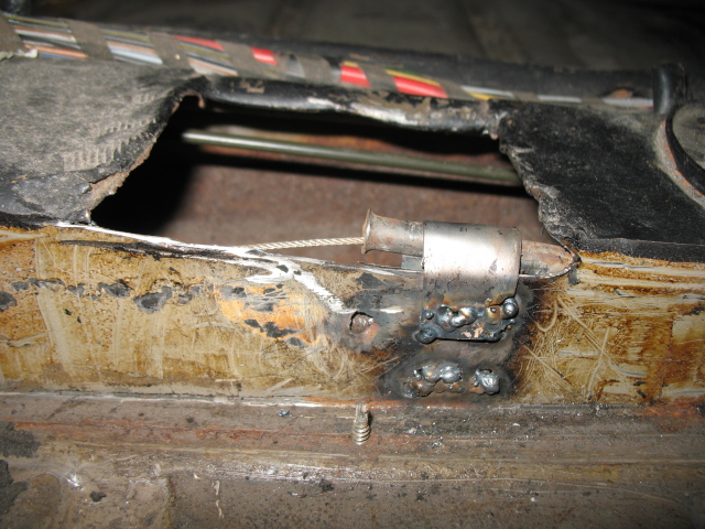

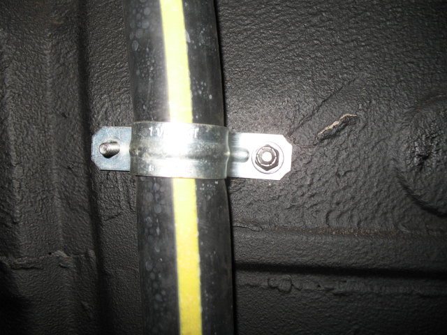

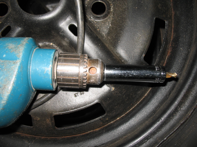

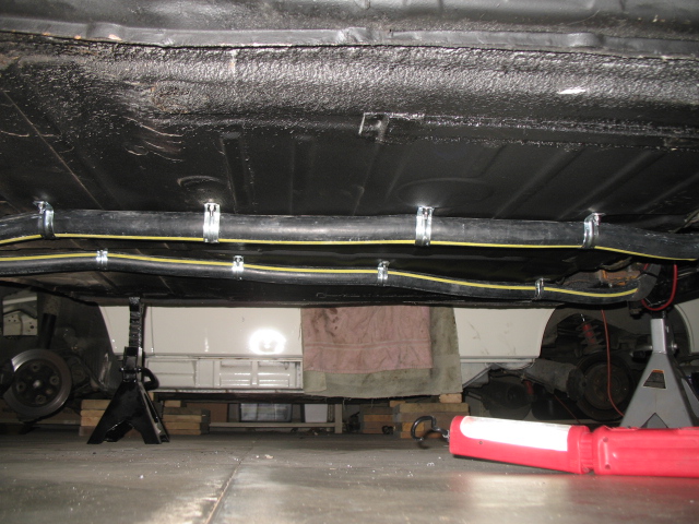

I decided to lose the sheet metal screws and replace with bolts tacked to the floor (so hose install/removal is a one man job), a washer and a nylock nut. the sheet metal screws' pointy top protruding into thru the cabin floor was an issue.
socket on drill bit when you only want to go thru but not full bit depth.
