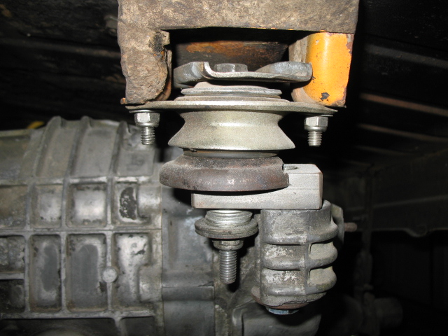

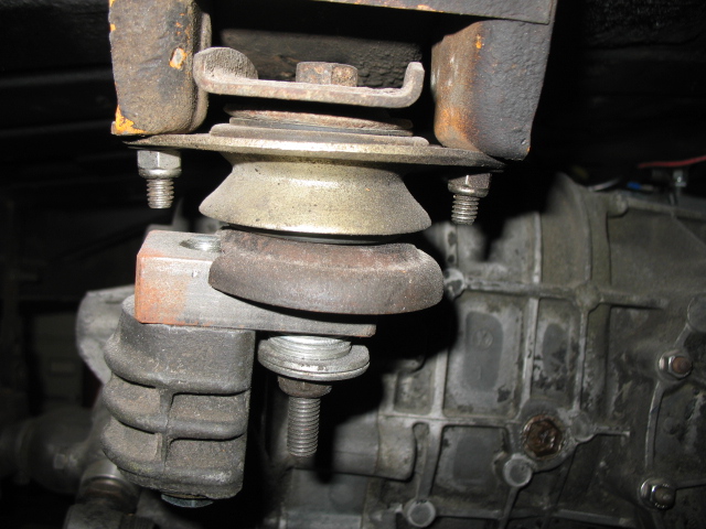

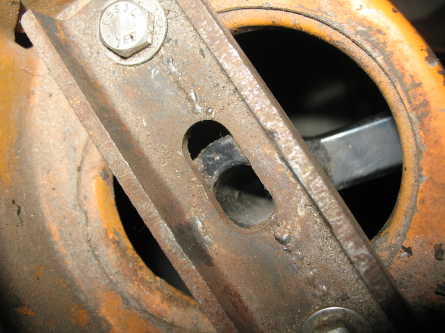

well two issues.
I need to either come up with a washer solution for the top bracket for engine mount, or I can just replace with rectangular steel and use longer main bolt. looking at the pic, I think I will get to perfect thick washers and grind the sides down so they will fit into the recess, might need 2 or three on each side.
second, do I need to move lower rear tranny mount washer to just above trans? right now it is just above the conversion/set back plate, above trans ear.
while making this video I realized I had some eng/trans movement.

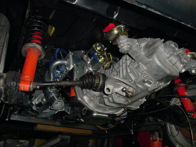

found this pics..
(IMG:http://www.914world.com/bbs2/uploads/post-2-1096639080.jpg)
(IMG:http://www.914world.com/bbs2/uploads/post-287-1153122207.jpg)

jimkelly   well two issues. I need to either come up with a ...   Oct 9 2013, 01:12 PM
JRust   The big washer with the groove goes on the bottom ...   Oct 9 2013, 03:17 PM
jimkelly   I have been searching and have yet to find a pic o...   Oct 9 2013, 04:57 PM
JRust   I have been searching and have yet to find a pic ...   Oct 10 2013, 07:20 AM
jimkelly   instead of this jumble of parts, I am thinking of ...   Oct 10 2013, 06:29 AM
bulitt   I'm thinking you will break your trans ears of...   Oct 10 2013, 06:50 AM
jimkelly   for engine mounts, found washers that fit perfectl...   Oct 10 2013, 07:34 AM
