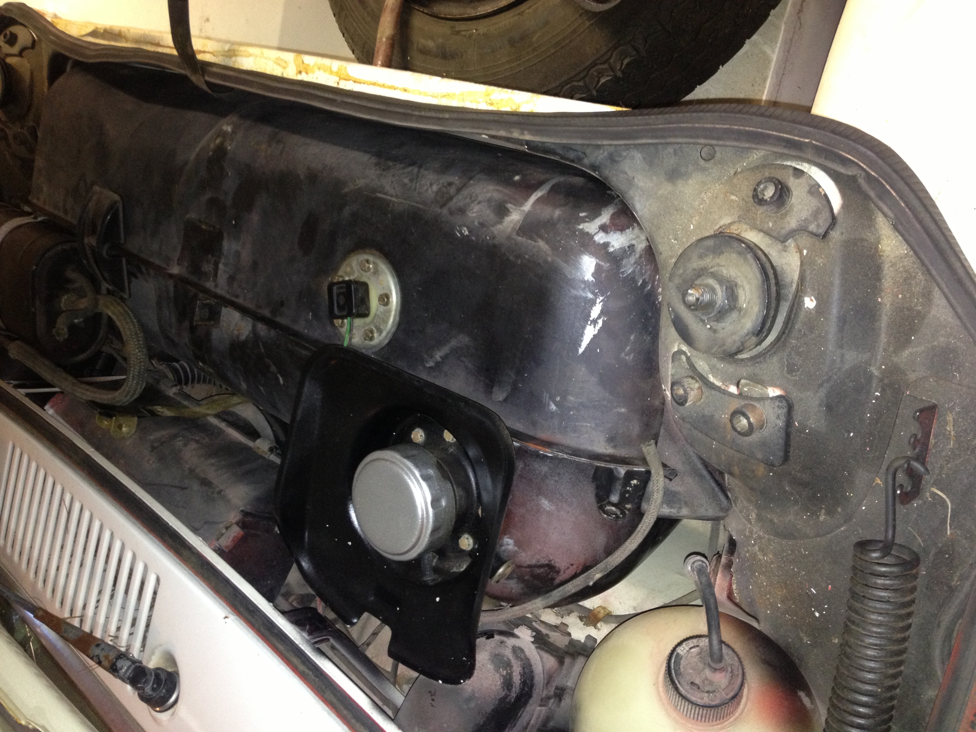

I finally got all my ignition parts in new battery wires plugs cap rotor condenser. Resealed the gas tank with the por-15 kit drained and clean all the old fuel lines changes oil and went to start it and its getting zero fuel to the carbs. I don't hear any electrical noise from the fuel punp when I turn the key to acc and I'm also not getting any juice to the plug at the top not unless my volt meter is broke.
So I guess my question is, is do I try and get new fuses and see if that changes anything? Trace the wires and try to find a short? Or buy either a replacement pump an aftermarket pump?
Thanks in advance for any advice.

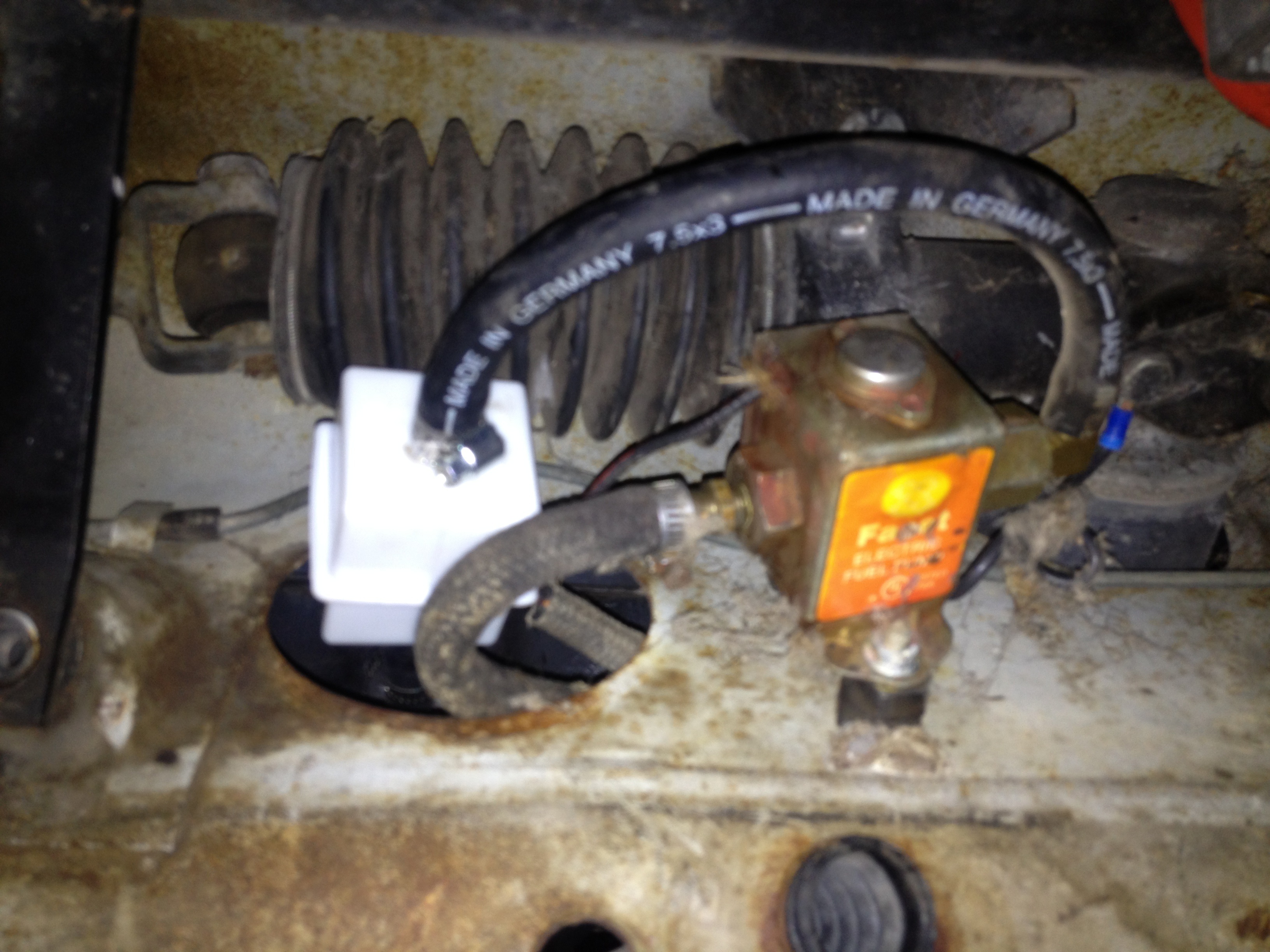

The fuel pump is located directly underneath of the gas tank.
When the car was running it had carbs I'm guessing someone else converted it along the way. Regardless I will have to check that as well. Here's a few pics if that helps.

SLITS   From the pics, they probably pulled power from the...   Oct 9 2013, 06:29 PM
bandjoey   That is an evil noisy aftermarket pump. Look at a ...   Oct 10 2013, 12:30 PM

SLITS   No fuel pump near the filler. The facet is the on...   Oct 11 2013, 10:24 PM
stefs914   No fuel pump near the filler. The facet is the o...   Oct 11 2013, 11:15 PM
