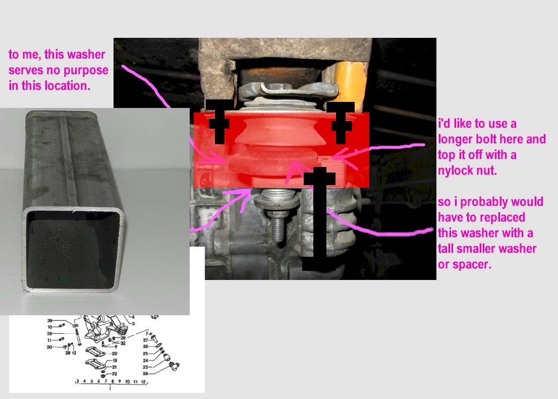

instead of this jumble of parts, I am thinking of installing a piece of 2" x 2" x 1/4" square steel tube which will require 3 holes and allow me to put a nylock nut on top of the bolt going thru the trans ear. reusing all hardware, just need the nylock nut.

bulitt   I'm thinking you will break your trans ears of...   Oct 10 2013, 06:50 AM
jimkelly   for engine mounts, found washers that fit perfectl...   Oct 10 2013, 07:34 AM

jimkelly   good point. behind trans is where the most space ...   Oct 10 2013, 09:51 AM
