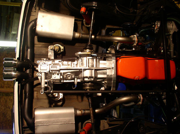

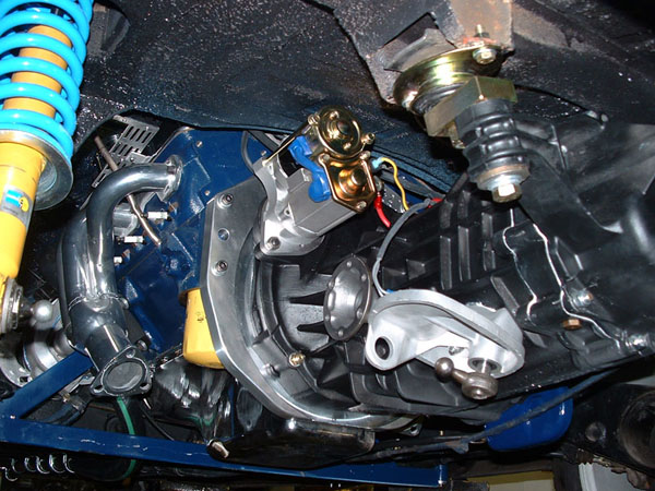

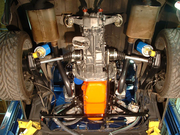

I'm thinking you will break your trans ears off if you go with a solid tube.
Heres some pics from Renegade site.
(IMG:http://www.914world.com/bbs2/uploads_offsite/www.renegadehybrids.com-13632-1381409433.1.jpg)
(IMG:http://www.914world.com/bbs2/uploads_offsite/www.renegadehybrids.com-13632-1381409433.2.jpg)
(IMG:http://www.914world.com/bbs2/uploads_offsite/www.renegadehybrids.com-13632-1381409434.3.jpg)
