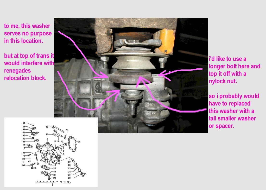

I have been searching and have yet to find a pic or drawing that has this washer at bottom of trans. but I see it belongs at top of trans under normal circumstances. though I can see where putting it at bottom in this circumstance makes sense.

QUOTE(jimkelly @ Oct 9 2013, 03:57 PM) *
Your right it is on top normally. I think it will still sit on top fine with renegade's block on top. Been a while since I messed with mine. I believe the lip it leaves will work. I may have used mine on the bottom flipped to accomplish the same thing. I guess it's worth trying both. Give Steve at Renegade a call (IMG:style_emoticons/default/idea.gif)

jimkelly   well two issues. I need to either come up with a ...   Oct 9 2013, 01:12 PM
JRust   The big washer with the groove goes on the bottom ...   Oct 9 2013, 03:17 PM
jimkelly   I have been searching and have yet to find a pic o...   Oct 9 2013, 04:57 PM
JRust   I have been searching and have yet to find a pic ...   Oct 10 2013, 07:20 AM
jimkelly   instead of this jumble of parts, I am thinking of ...   Oct 10 2013, 06:29 AM
bulitt   I'm thinking you will break your trans ears of...   Oct 10 2013, 06:50 AM
jimkelly   for engine mounts, found washers that fit perfectl...   Oct 10 2013, 07:34 AM
