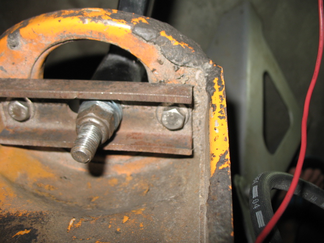

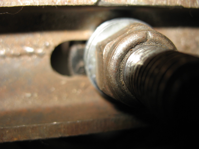

for engine mounts, found washers that fit perfectly at ACE : )
and I agree about concerns of breaking off trans ear. certainly would have to make sure to loosen trans mount bolts BEFORE engine mount bolts, before tilting eng/trans assy at all. though I may just leave it as it is? maybe I just need a robust lock washer on the bolt going up thru the trans ear and into the renegade block as it appears some have done.
still getting some eng/trans shifting when shifting thru gears?
and I do see my rear most trans bushing is shot.
