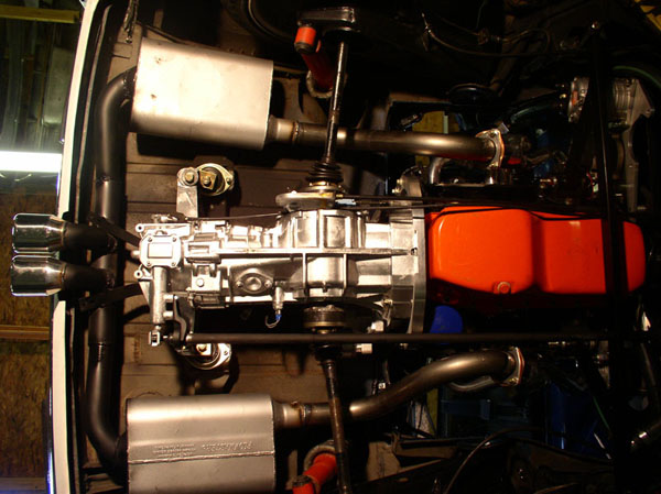

Hijack but this exhaust setup is AWESOME
That's how I eventually want to connect mine from the muffler exits back.

Chris H.   Hijack but this exhaust setup is AWESOME That...   Oct 10 2013, 09:43 AM
jimkelly   good point. behind trans is where the most space ...   Oct 10 2013, 09:51 AM
mittelmotor   I like the 2-in/2-out approach as well. Keeps the ...   Oct 10 2013, 01:22 PM
