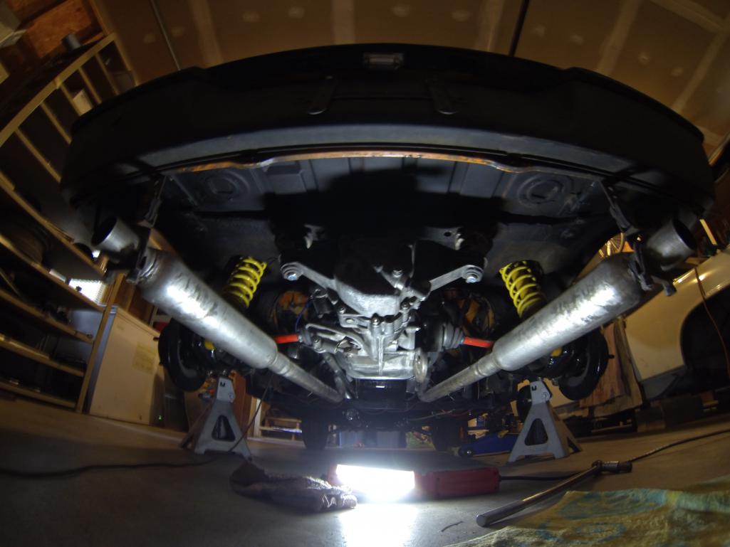

good point. behind trans is where the most space available for a cross over, I agree it is a good design and over axles is nice too, all tucked up.
shorter mufflers are the key and my hugger headers are NOT a good starting point.
but skline had a nice clean set up too. a 2 in 2 out muffler.
(IMG:http://www.914world.com/bbs2/uploads/post-1170-1284011533_thumb.jpg)

Chris H.   Hijack but this exhaust setup is AWESOME That...   Oct 10 2013, 09:43 AM
jimkelly   good point. behind trans is where the most space ...   Oct 10 2013, 09:51 AM
mittelmotor   I like the 2-in/2-out approach as well. Keeps the ...   Oct 10 2013, 01:22 PM
