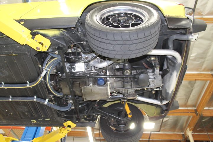

I like the 2-in/2-out approach as well. Keeps the sound level reasonable. Note hidden dump pipe on far side for stealth (relative term here for V-8 conversions!).

Chris H.   Hijack but this exhaust setup is AWESOME That...   Oct 10 2013, 09:43 AM
jimkelly   good point. behind trans is where the most space ...   Oct 10 2013, 09:51 AM
