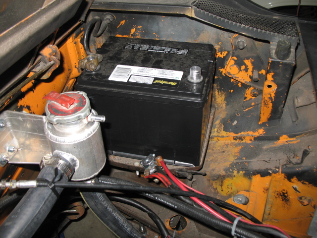

well, finally got a battery today. hooked it up, and tested the starter. engine cranked over nicely (starter seems to be fully engage flywheel teeth - whew) and fuel pump ran. maybe tomorrow i'll stick the gas line into a gas can and fill the cooling system, and see if she starts. hopefully the timing is not too far off.
