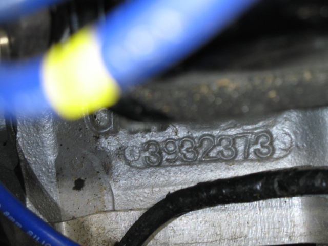

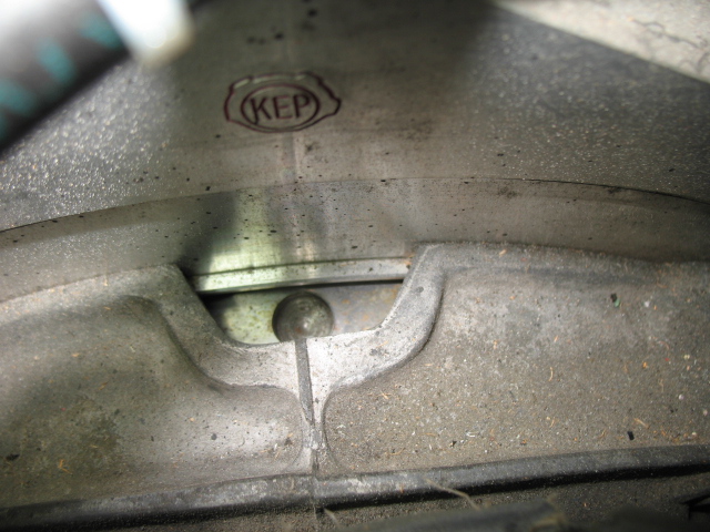

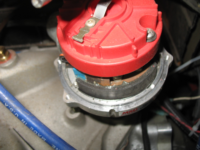

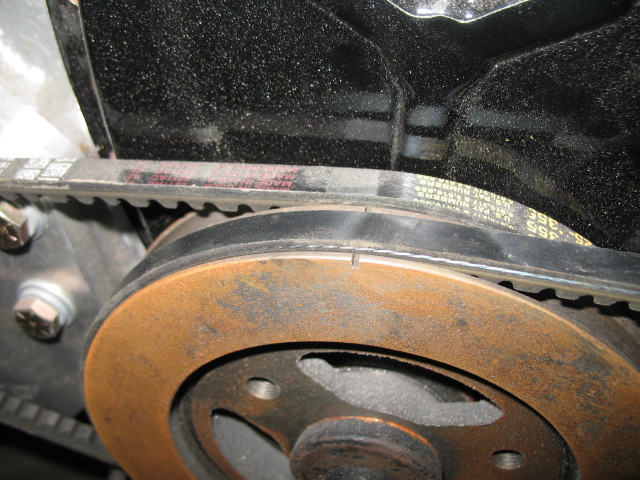

hooked my fuel to gas but she backfires and pops. I am sure I have my spark plug wires wrong.
is it safe to say that if the notch on the front pully is directly up, then where the rotor points is #1 ?? engine is a 307. #3932373
she sputtering and back firing but not starting (IMG:style_emoticons/default/blink.gif)
or is this round mark at top of flywheel the tdc mark, indicating #1?
the pulley mark when at top is not when the flywheel mark is at top and vice versa. though it think the flywheel also has a straight line mark on it too? and I think it need to be visable thru bottom of trans view port?

jimkelly   hooked my fuel to gas but she backfires and pops. ...   Oct 11 2013, 07:24 AM
wndsrfr   hooked my fuel to gas but she backfires and pops....   Oct 11 2013, 07:53 AM
DBCooper   or is this round mark at top of flywheel the tdc ...   Oct 11 2013, 09:51 AM
jimkelly   firing order seems to be 18436572 but finding tdc ...   Oct 11 2013, 08:22 AM
jimkelly   thanks guys, you've given me good guidance. dt...   Oct 11 2013, 10:36 AM
tooms351   Run a wire with allegator clips from starter selen...   Oct 11 2013, 04:40 PM
jimkelly   I basically have the with my console - but will tr...   Oct 11 2013, 05:52 PM
DBCooper   It looks like the number 1 wire goes up to the lef...   Oct 11 2013, 04:42 PM
jimkelly   all the images i found have cylinders 1-2 3-4 5-6...   Oct 11 2013, 05:24 PM
jimkelly   db I could kiss you, right on the mouth. GREAT eye...   Oct 11 2013, 06:09 PM
