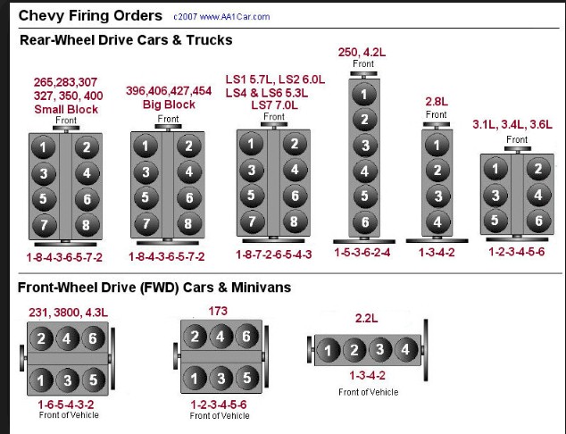

post Oct 11 2013, 08:22 AM
Delaware USA
Posts: 4,969
Joined: 5-August 04
From: Delaware, USA
Member No.: 2,460
firing order seems to be 18436572
but finding tdc is gonna be my challenge it seems
guess I got to pull a valve cover off first,and all spark plugs
thanks

DBCooper   or is this round mark at top of flywheel the tdc ...   Oct 11 2013, 09:51 AM
jimkelly   firing order seems to be 18436572 but finding tdc ...   Oct 11 2013, 08:22 AM
jimkelly   thanks guys, you've given me good guidance. dt...   Oct 11 2013, 10:36 AM
tooms351   Run a wire with allegator clips from starter selen...   Oct 11 2013, 04:40 PM
jimkelly   I basically have the with my console - but will tr...   Oct 11 2013, 05:52 PM
DBCooper   It looks like the number 1 wire goes up to the lef...   Oct 11 2013, 04:42 PM
jimkelly   all the images i found have cylinders 1-2 3-4 5-6...   Oct 11 2013, 05:24 PM
jimkelly   db I could kiss you, right on the mouth. GREAT eye...   Oct 11 2013, 06:09 PM
