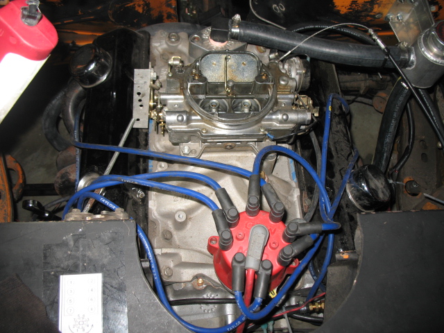

thanks guys, you've given me good guidance. dtf. no way can I rotate the engine by turning a wheel, too stiff. pushing the car while in gear is hell too. and the bolt holding the front pulling in place seems stripped. this is not gonna be fun : (
well, I had all plugs out and valve covers off. I "ROLLED" it forward and backwards and thought I had #1 cylinder on compression stroke, from seeing intake valve engage and then settle out and piston seemed to be at top of stroke. at first she just cranked over, so I added some fuel directly into the carb and then she4 spat out the carb and back fired thru exhaust. not much change.
looks like I need a new tool. the only problem is I don't have a smooth way to turn engine. psi and vaccum tool.
https://www.youtube.com/watch?v=u2sA-q7_FtQ

DBCooper   or is this round mark at top of flywheel the tdc ...   Oct 11 2013, 09:51 AM
jimkelly   firing order seems to be 18436572 but finding tdc ...   Oct 11 2013, 08:22 AM
jimkelly   thanks guys, you've given me good guidance. dt...   Oct 11 2013, 10:36 AM
tooms351   Run a wire with allegator clips from starter selen...   Oct 11 2013, 04:40 PM
jimkelly   I basically have the with my console - but will tr...   Oct 11 2013, 05:52 PM
DBCooper   It looks like the number 1 wire goes up to the lef...   Oct 11 2013, 04:42 PM
jimkelly   all the images i found have cylinders 1-2 3-4 5-6...   Oct 11 2013, 05:24 PM
jimkelly   db I could kiss you, right on the mouth. GREAT eye...   Oct 11 2013, 06:09 PM
