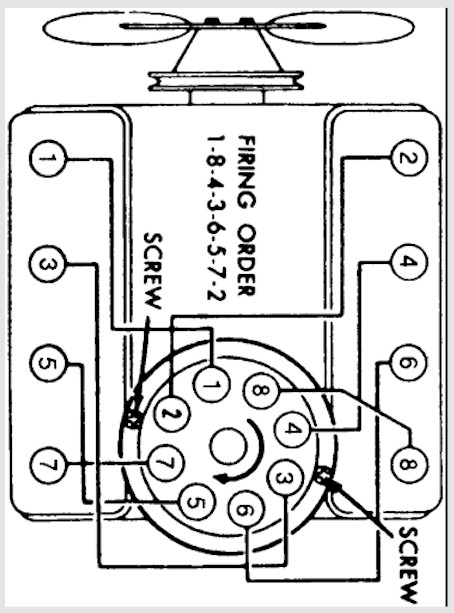

all the images i found have cylinders
1-2
3-4
5-6
7-8
distributor
I really think it is ready to run, but I am f-in something up
(IMG:http://www.914world.com/bbs2/uploads/post-2460-1379702706.jpg)
holy shit - do I have them completely backwards ????????????
the frist graphic I found was correct (ABOVE), but I taped a different graphic to my car because it was less clutterd but I did not notice it had the rotation different/wrong.
I just removed the graphics with the incorrect rotation from this post.

DBCooper   or is this round mark at top of flywheel the tdc ...   Oct 11 2013, 09:51 AM
jimkelly   firing order seems to be 18436572 but finding tdc ...   Oct 11 2013, 08:22 AM
jimkelly   thanks guys, you've given me good guidance. dt...   Oct 11 2013, 10:36 AM
tooms351   Run a wire with allegator clips from starter selen...   Oct 11 2013, 04:40 PM
jimkelly   I basically have the with my console - but will tr...   Oct 11 2013, 05:52 PM
DBCooper   It looks like the number 1 wire goes up to the lef...   Oct 11 2013, 04:42 PM
jimkelly   all the images i found have cylinders 1-2 3-4 5-6...   Oct 11 2013, 05:24 PM
jimkelly   db I could kiss you, right on the mouth. GREAT eye...   Oct 11 2013, 06:09 PM
