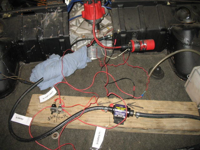

wiring my v8
and tell me what I have wrong or missing.
my bad for never labeling the wires (IMG:style_emoticons/default/headbang.gif)
distributor is msd 8360
but you guys are smart (IMG:style_emoticons/default/smoke.gif)
and yes - I better connect that oil guage line or I will have a mess on my hands.

Run a wire with allegator clips from starter selenoid to hot side of battery, but just tap battery to turn engine over. Put your finger over #1 spark plug hole to determine compression stroke, good luck!!!

I basically have the with my console - but will try with finger checking for pressure.
(IMG:http://www.914world.com/bbs2/uploads/post-2460-1381434074.jpg)
QUOTE(tooms351 @ Oct 11 2013, 03:40 PM) *
