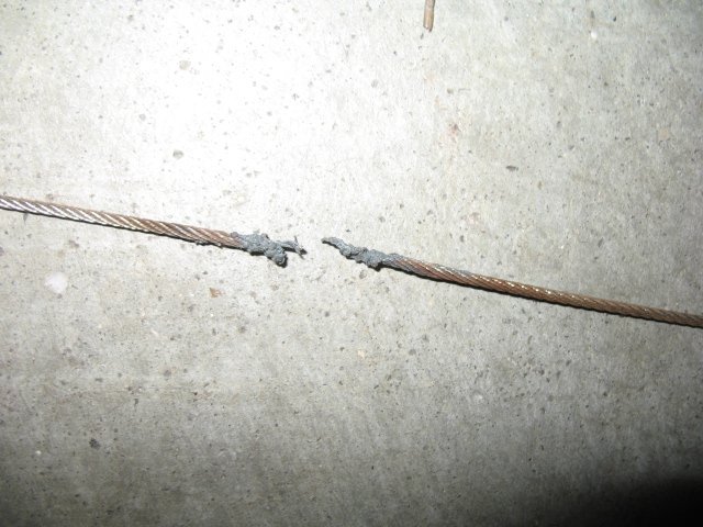

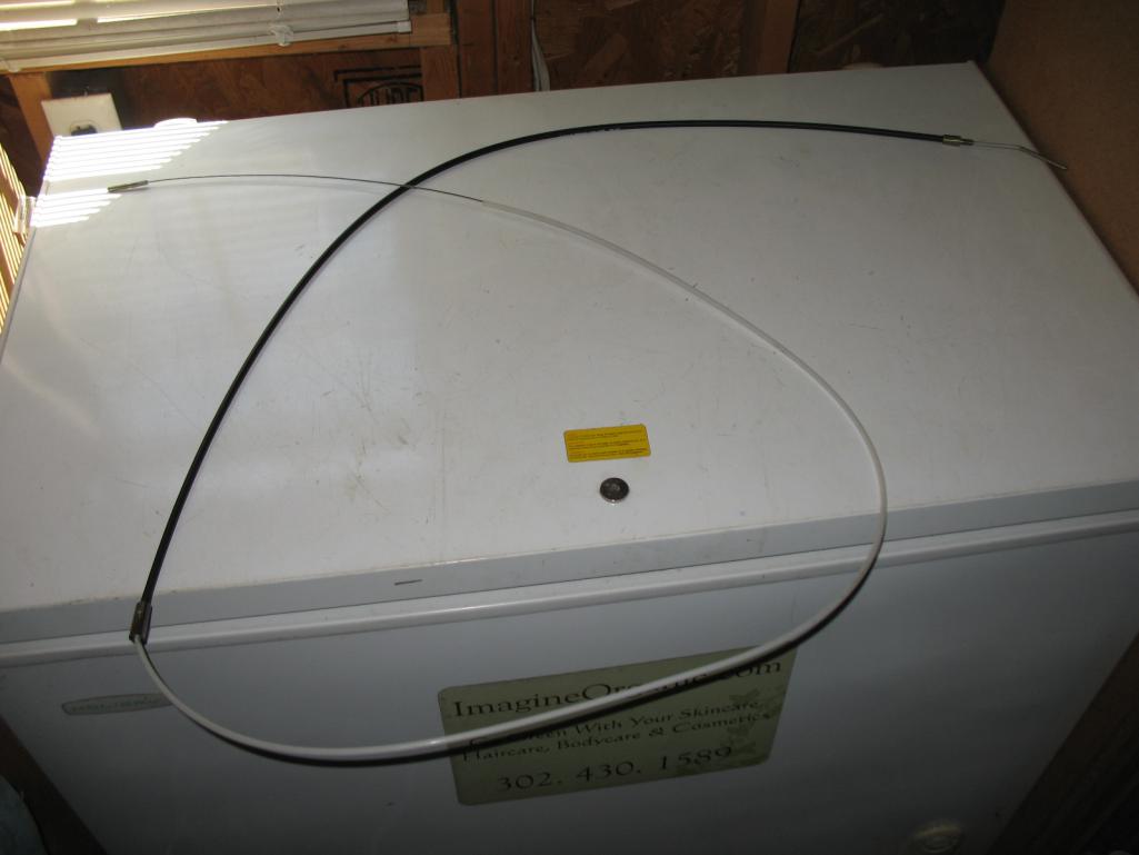

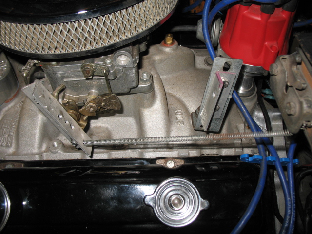

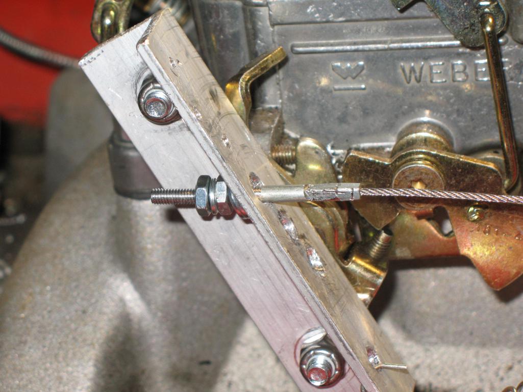

attached my throttle bracket and throttle cable, all looked good till I pressed the peddle, and snap. I got an email into terry cable to replace the one that is in my car.
119.5" total, 58" sheathing.
I do need need to drill one more hole in my throttle bracket and get the perfect spring.

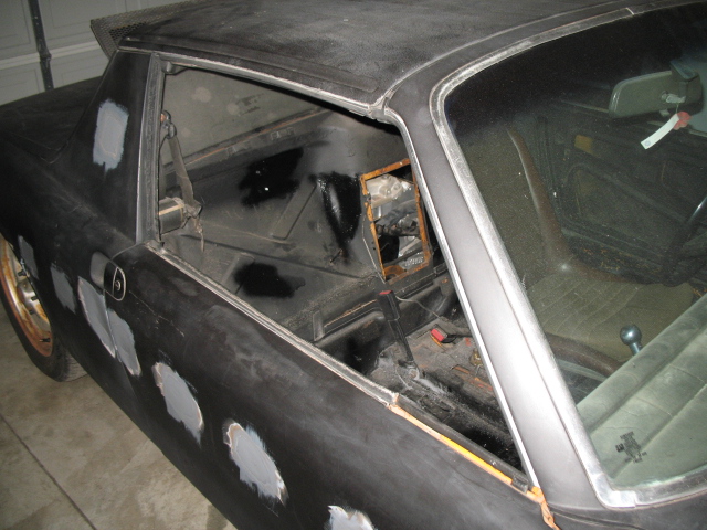

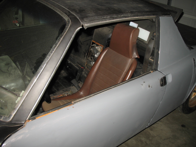

and all early door, door glass, removed from my fair weather car.
