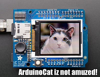

I've been pondering this project for awhile, and now I'm finally getting ready to start. Every time I synch carbs I think about how terrible and approximate the process is. What I'm going to try is using a small, programmable computer called an Arduino. There are add-ons called Shields to expand the functionality, and I'm using a LCD screen shield. I'm going to hook up 4 to 6 MAP sensors to the Arduino and output their readings on the screen. Using this tool, I'll be able to numerically evaluate the relative balance of the carb throats.
One possible shortcoming is that the intake pulses may create fluctuating values that are difficult to interpret. Although, I have some ideas that may deal with this. Some sort of averaging could help. (IMG:style_emoticons/default/idea.gif)
Here's what the Arduino looks like (this is the Uno version)
(IMG:http://www.914world.com/bbs2/uploads_offsite/www.adafruit.com-419-1381898348.1.jpg)
Here's the screen shield
(IMG:http://www.914world.com/bbs2/uploads_offsite/www.adafruit.com-419-1381898349.2.jpg)
