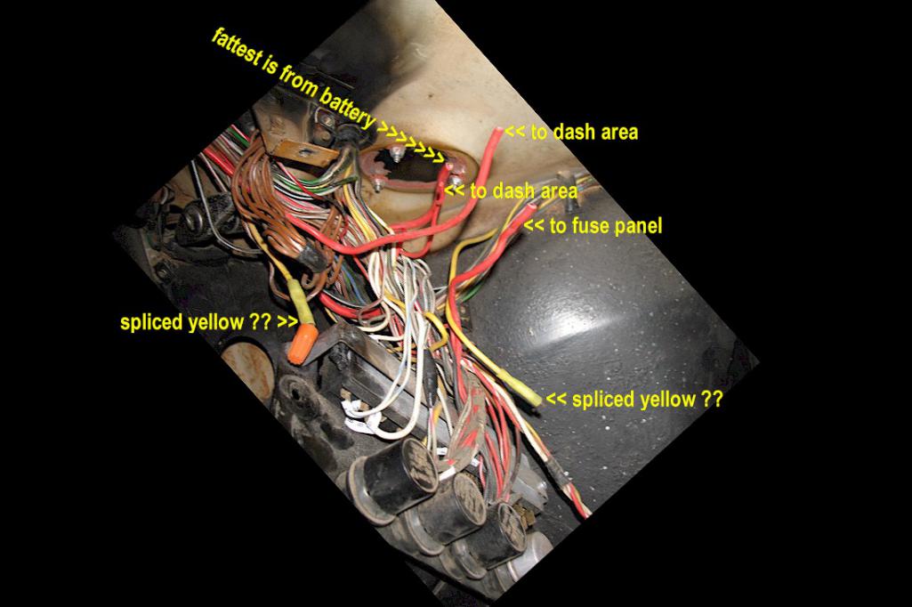

wiring my v8
and tell me what I have wrong or missing.
my bad for never labeling the wires (IMG:style_emoticons/default/headbang.gif)
distributor is msd 8360
but you guys are smart (IMG:style_emoticons/default/smoke.gif)
and yes - I better connect that oil guage line or I will have a mess on my hands.

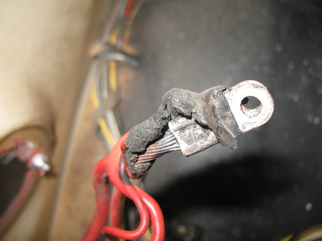

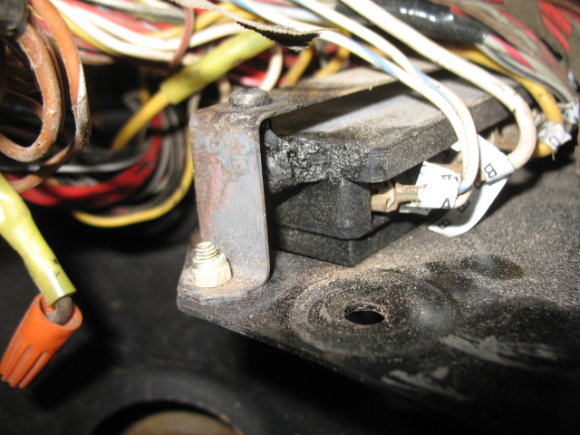

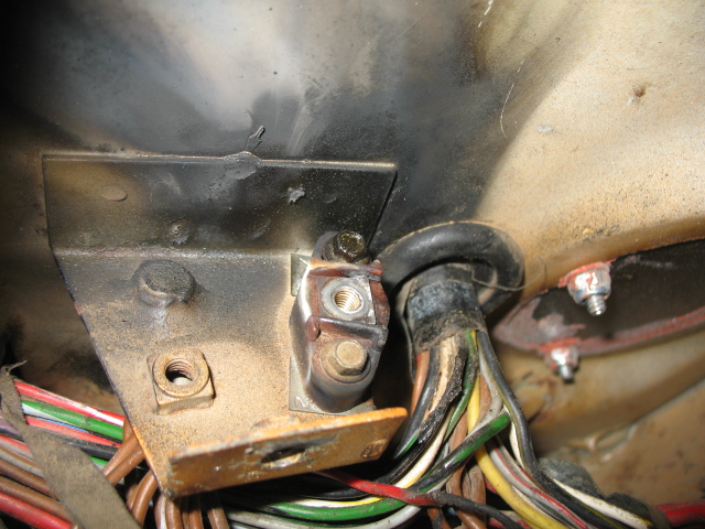

set back. fuse box was in contact with block and started a fire. not too bad luckily.
here is a past thread on this main topic.
http://www.914world.com/bbs2/index.php?sho...=185880&hl=
having a quickly available battery quick disconnect makes more sense than ever.
better this happened with car in garage than 100 miles from home.
how do I splice these 4 RED wires together, properly?

3d914   IIRC the yellow wire goes to the positive side of ...   Sep 16 2013, 01:01 PM
jimkelly   thank you - I am editing my collage as we go. jim   Sep 16 2013, 01:05 PM
Spoke   Page 5: Red wire from harness is 12V power to coil...   Sep 16 2013, 02:13 PM
