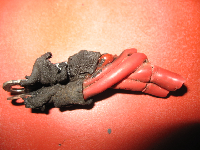

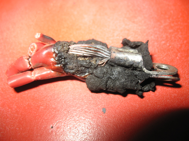

I neglected the first rule - disconnect battery when working on electrical.
and did not benefit from those with early cars that experienced the same issue before me.
lesson learned.

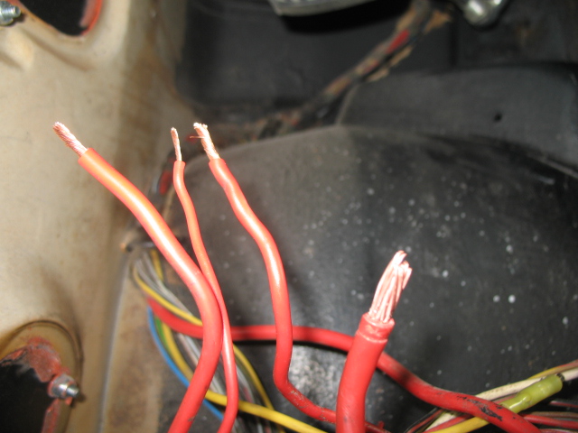

I will definitely look over my wires, I see at three that need to be sectioned.

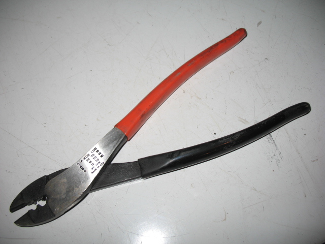

also, I need to find a big crimp butt splice that can accommodate the main hot from battery on one side and the 3 smaller wires on the other. (pic)
and hopefully my crimper will suffice, it does down to 10 gage.
I have some red, blue and yellow, insulated connectors, but even yellow is not large enough for the hot from battery. I think I need 8 awg.

jimkelly   set back. fuse box was in contact with block and ...   Oct 16 2013, 02:10 PM
Chris H.   Whew you dodged a bullet on that one Jim. Check J...   Oct 16 2013, 06:35 PM
jimkelly   I neglected the first rule - disconnect battery wh...   Oct 16 2013, 06:49 PM
