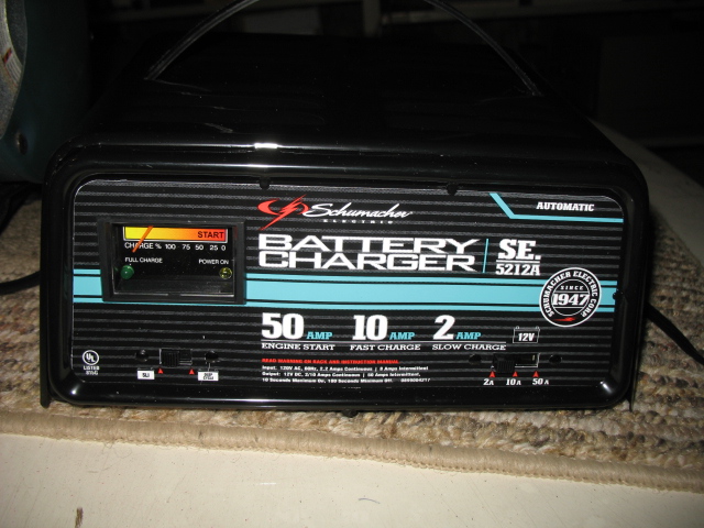

I thought I may have fried my coil or dist but thank god I did not.
picked up a battery charger today at advanceauto $60 new, charged battery, and she started right up : )
like a dummy I had pushed the fuel line so far into the gas can that it wound up not being in fuel, and would not start, thus drained battery, and needed charger (IMG:style_emoticons/default/smile.gif)

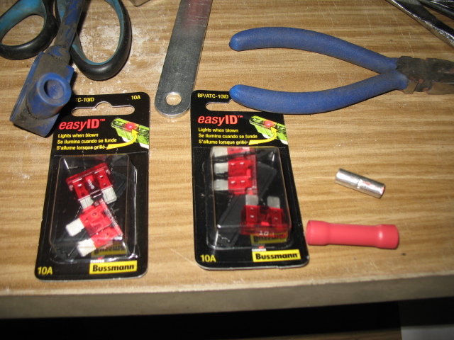

ok - back to repairing fried wires near the fuse box and need to add coolant to the cooling system. picked up some smart fuses and some 8 gage butt connectors.
lots of pics for those of you less mechanically inclined than me, but my guees is there are none : )
got some easy id fuses but they are 10amp, advance did not have 7.5, but later I found some 7.5 amp fuses on ebay and ordered a few.
