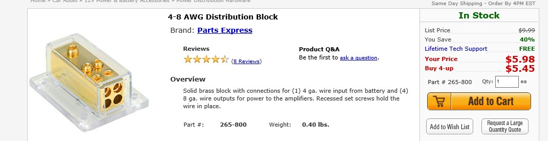

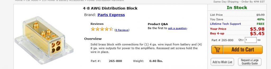

price is right.
once this Bacardi wears off, I can give your suggestion some real thought (IMG:style_emoticons/default/smile.gif)
