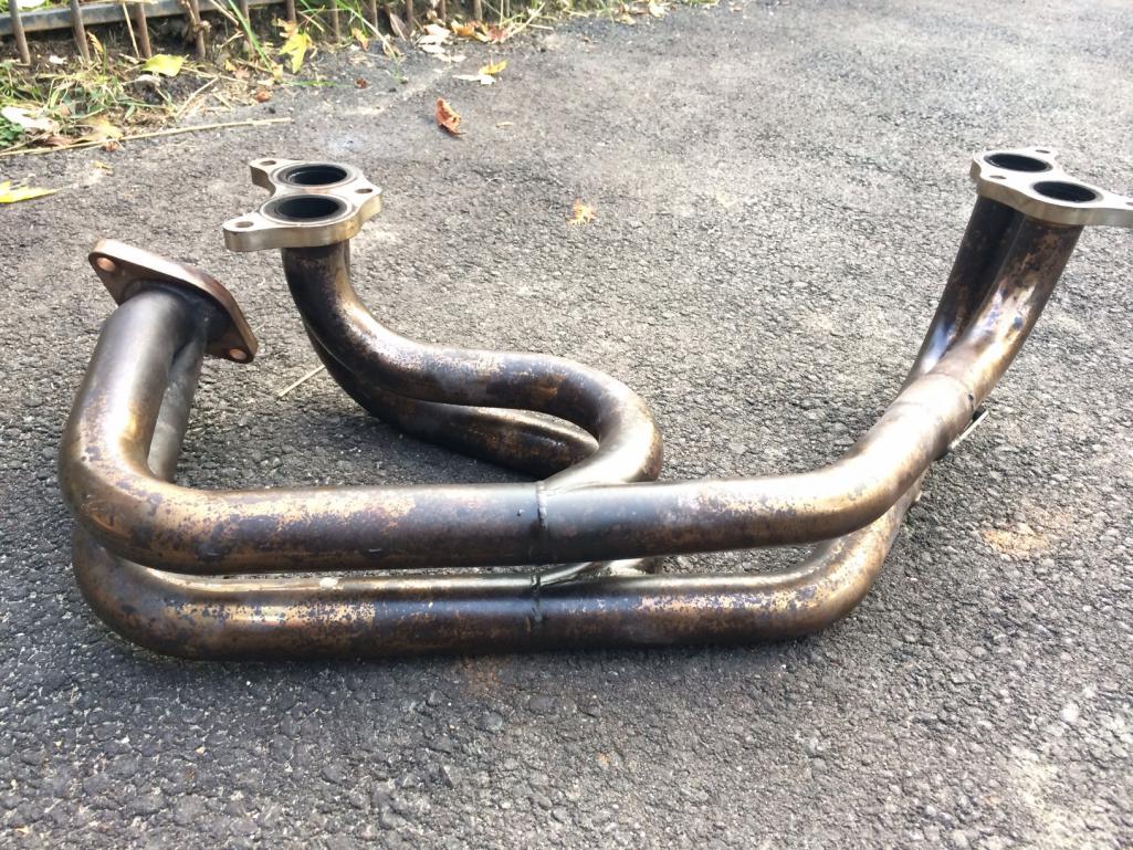

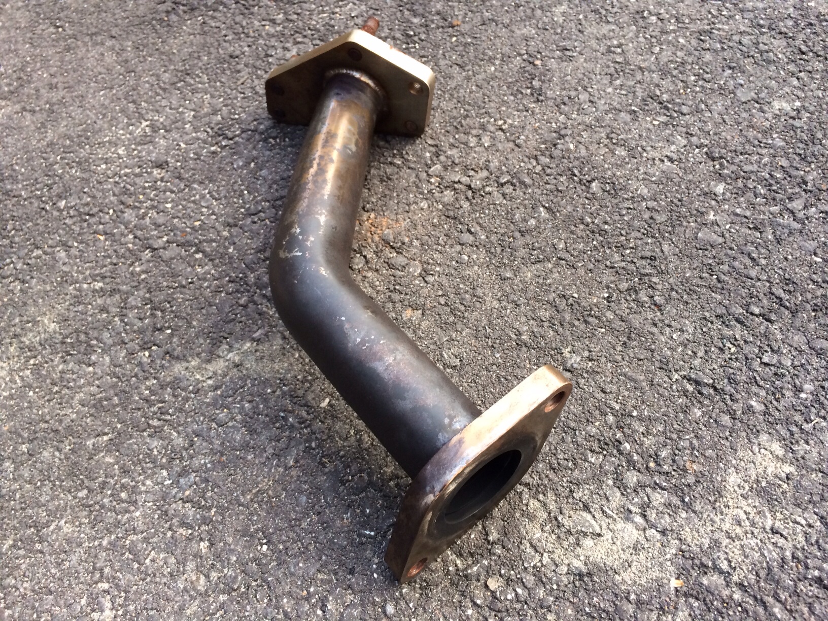

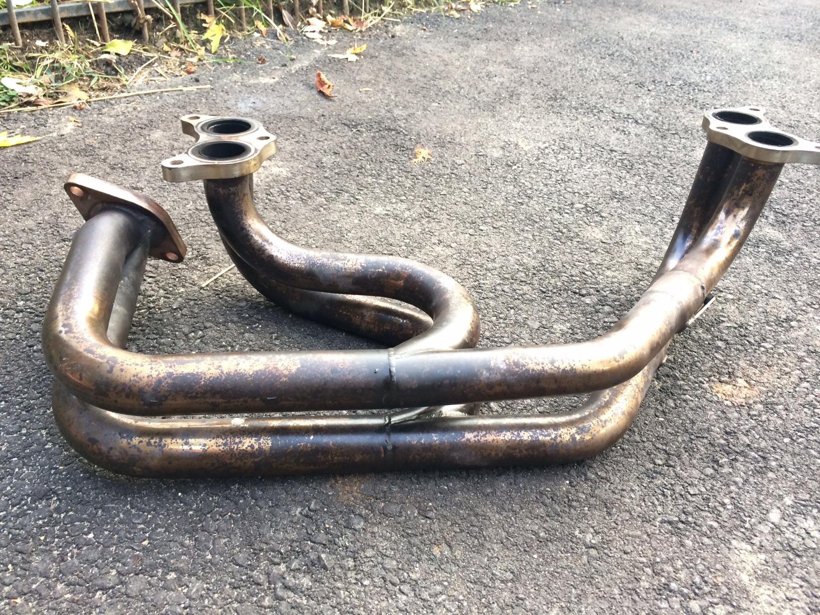

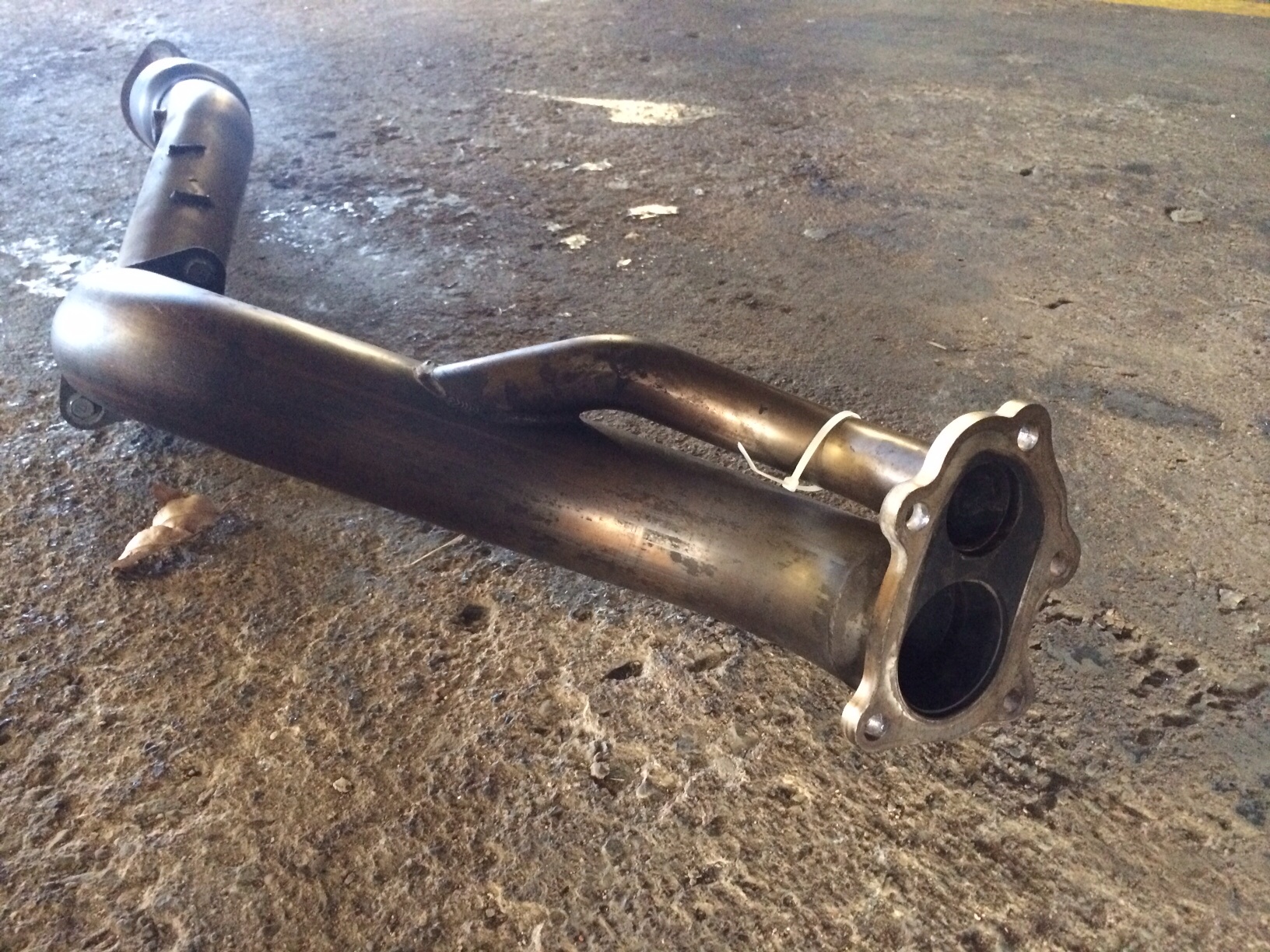

Here be da pics.
http://www.914world.com/bbs2/index.php?s=&...t&p=1942876
As soon as I get it the motor in the car, I'll get to the (IMG:style_emoticons/default/sawzall-smiley.gif) and flip that down-pipe the right direction.
I have a feeling I'll have about 4' of 3" pipe left over from it though.
