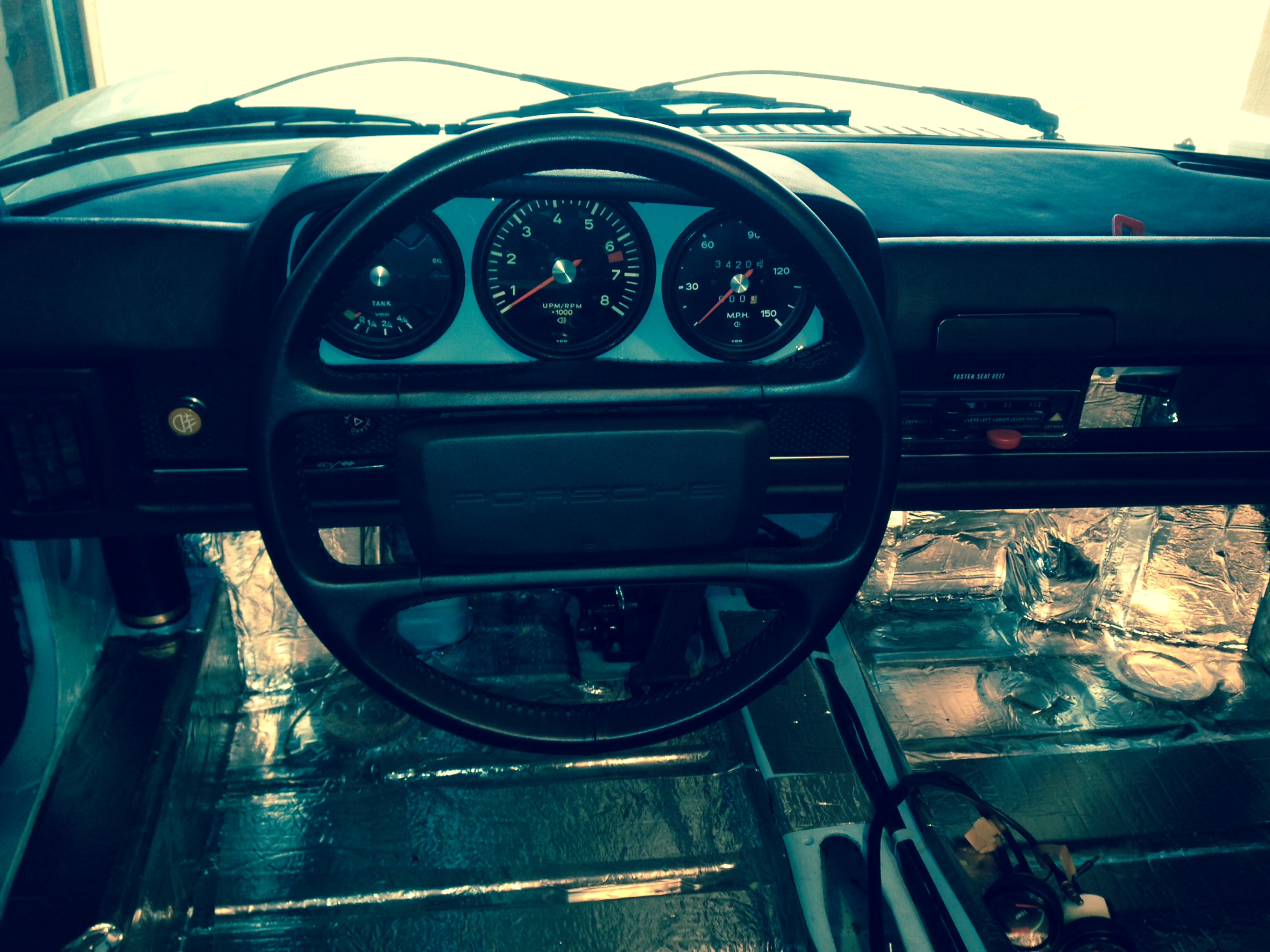

PanelBilly   I installed new rubber seals in the front trunk an...   Oct 20 2013, 04:27 PM
PanelBilly   I also go the steering wheel installed   Oct 20 2013, 04:33 PM
Evil Older Brother   I also go the steering wheel installed Nice wh...   Oct 20 2013, 05:12 PM
CptTripps   Looking great man!   Oct 20 2013, 05:13 PM
Daiberl   Nice progress! I will try to come down in the ...   Oct 20 2013, 05:39 PM
