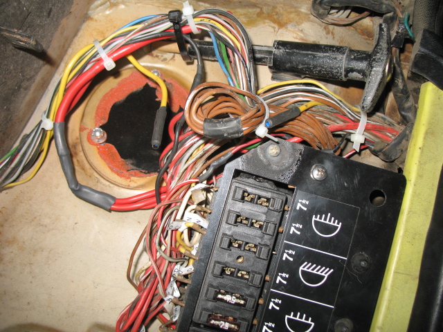

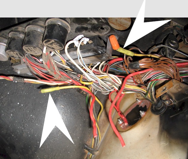

wiring my v8
and tell me what I have wrong or missing.
my bad for never labeling the wires (IMG:style_emoticons/default/headbang.gif)
distributor is msd 8360
but you guys are smart (IMG:style_emoticons/default/smoke.gif)

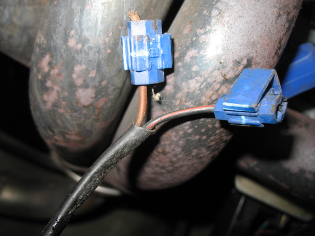

lastly, since I owned this car, I am pretty sure these yellow wires were never connected but must have been at one time. I don't understand what this yellow wire that goes thru tunnel is supposed to do. seems it is a starter wire?

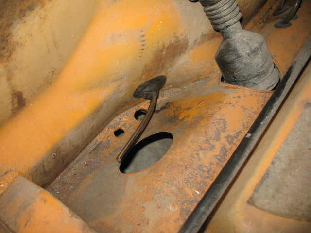

fuel line in - the front grommet wasn't too hard to get in once I lubed it with soap - and I can see my fuel pump's pos and neg wires.

3d914   IIRC the yellow wire goes to the positive side of ...   Sep 16 2013, 01:01 PM
jimkelly   thank you - I am editing my collage as we go. jim   Sep 16 2013, 01:05 PM
Spoke   Page 5: Red wire from harness is 12V power to coil...   Sep 16 2013, 02:13 PM
jimkelly   spoke I am pretty sure my ignition switch was par...   Sep 16 2013, 02:30 PM
jmmotorsports   spoke I am pretty sure my ignition switch was pa...   Sep 17 2013, 04:15 AM
chads74   spoke I am pretty sure my ignition switch was p...   Sep 17 2013, 06:19 AM
jimkelly   spoke image 6 - the blue wire loops around and co...   Sep 16 2013, 07:31 PM
Spoke   spoke image 6 - the blue wire loops around and c...   Sep 17 2013, 06:49 AM
dwillouby   I dont use the relay board. You need a switched 12...   Sep 17 2013, 06:42 AM
jimkelly   I was thinking that since it seems to be the only ...   Sep 17 2013, 07:03 AM
jimkelly   finally going to put my crimper and heat shrink to...   Sep 17 2013, 08:01 AM

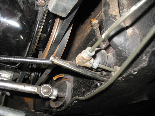

jimkelly   engine bay shift rod done : ) 40.75" it is ...   Sep 21 2013, 01:15 PM

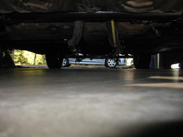

jimkelly   good point. behind trans is where the most space ...   Oct 10 2013, 09:51 AM
mittelmotor   I like the 2-in/2-out approach as well. Keeps the ...   Oct 10 2013, 01:22 PM

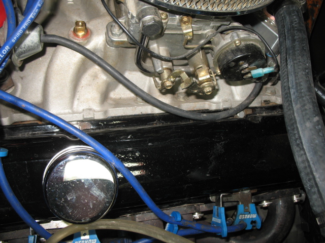

jimkelly   well, finally got a battery today. hooked it up, ...   Oct 10 2013, 01:41 PM
jimkelly   hooked my fuel to gas but she backfires and pops. ...   Oct 11 2013, 07:24 AM

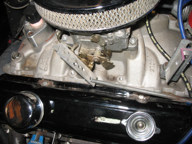

jimkelly   attached my throttle bracket and throttle cable, a...   Oct 14 2013, 08:55 AM
