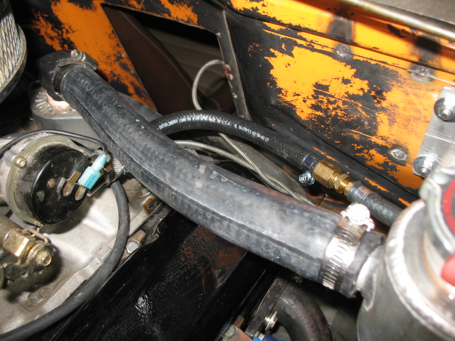

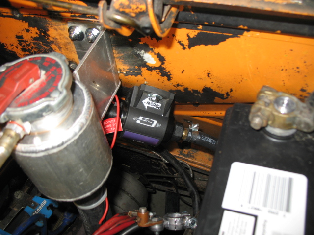

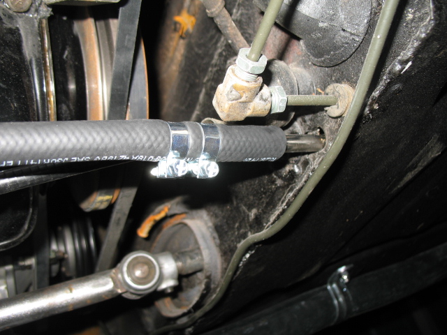

plumbed to carb from firewall, pump and filter.
note to self: get a grommet or bushing onto the fuel line where it enters the firewall. and need a ring connector to replace the mechanical lug on the pos + battery terminal.
