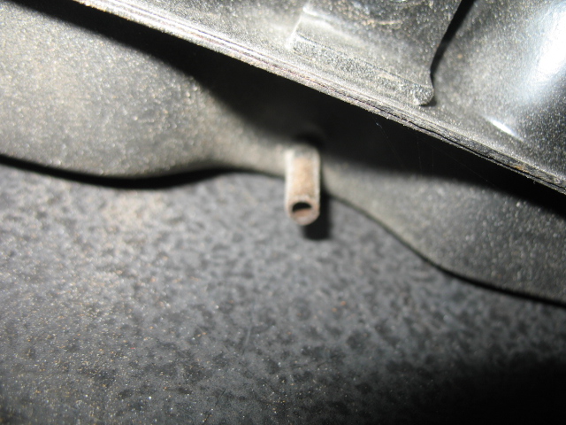

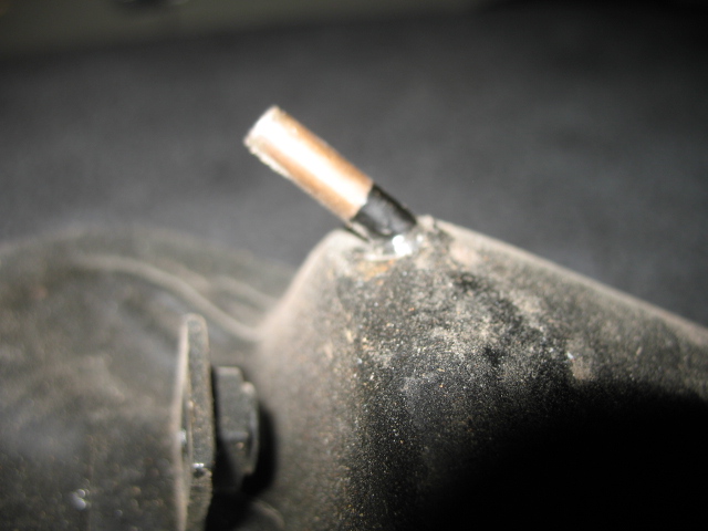

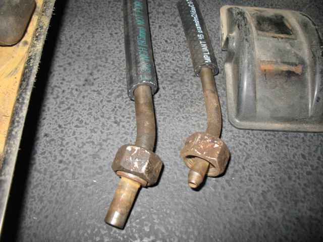

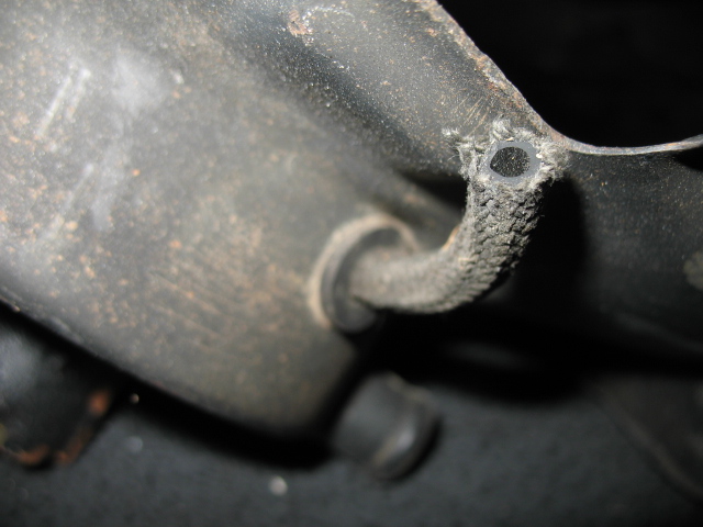

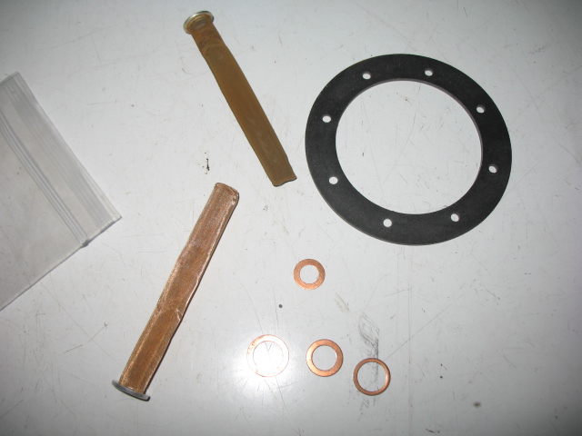

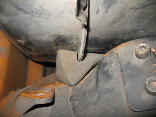

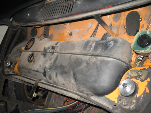

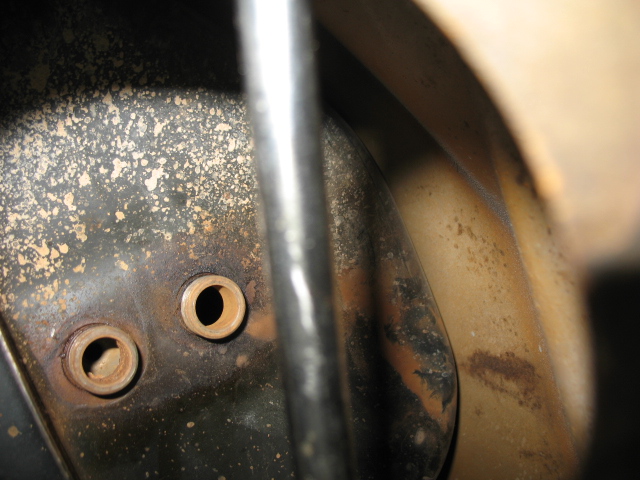

next to install fuel tank and plug the return line.
I need to remember why I ordered 4 metal gaskets, when I only need two. that I can see?
ok - I see how the rubber blocks sit on each side of the tank. I was thinking of setting the tank and doing the fuel lines from the bottom but I think I will go with a long line and hook up before tank install.
