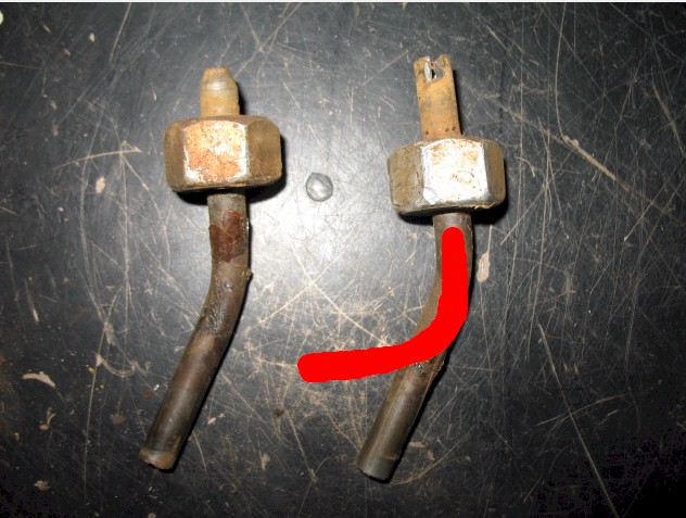

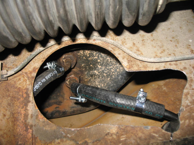

got my fuel tank in and fuel pump wired. I need to locate my fuel sending unit which has a different plug than a late model it seems.
got my 7.5amp fuses today and my headlights low and high beams work, always did before.
but I have a new electrical gremlin. I assume it has something to do with me oppsing a wire or two, when installing the engman fuse panel?
the new one is this, when I pull the hazard switch, my fuel pump comes on?
my fuel pump also comes on as it should when I turn the ignition key, with hazards off.
I ended up cutting away some sheet metal and shortening the fuel line under stank, so I could make last fuel line connection to tunnel fuel line from under the car.
as was suggested in another thread, I should have made a round disk out of rubber and used it and a washer and the normal nut to cap off the return line.
also it appears that the later cars used the same diameter nipples for both, where as my 1972 car had a larger line 3/8 to engine and 5/16 return.
for me, going straight from tank to tunnel line, I think a tighter curve on the nipples would have been much better, on both, even the capped off return.
