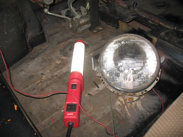

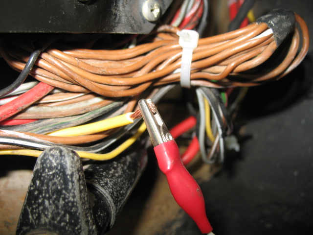

I could have sworn my car started from key with this fat yellow wire disconnected, but it was driving me crazy, so I just tested the yellow wire and it does produce power when key is fully turned. so what must have happened is butt connection came apart and I did not put 2 and 2 together. be thankful you have more functioning brain cells than i do.
I still have 2 gremlins, drivers side parking light does not blink when headlights are on and fuel pump comes on when I pull hazard switch. but at least I won't have to wire up a rigged momentary starter switch.
obviously I am using a headlight to do my electrical circuit testing.
