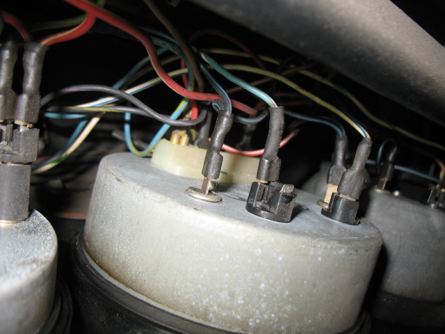

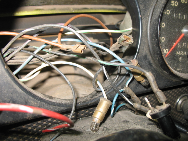

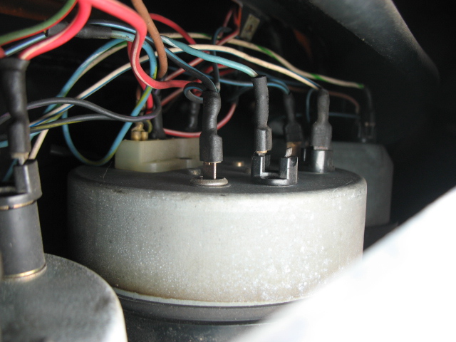

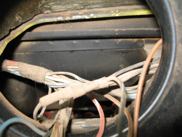

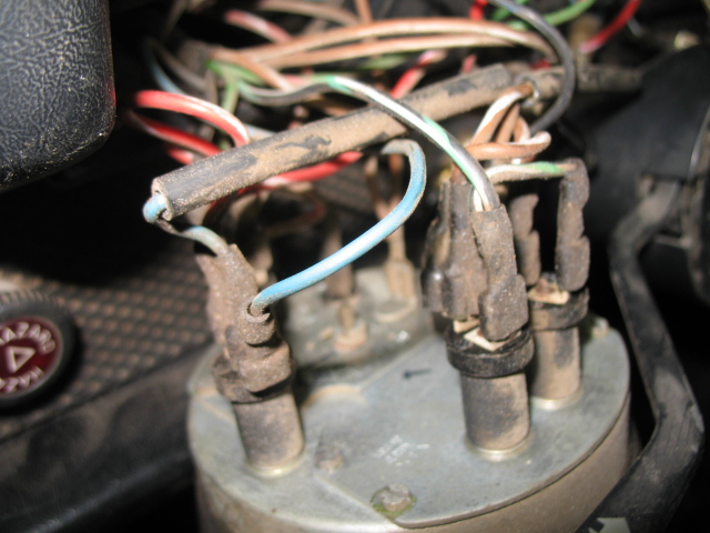

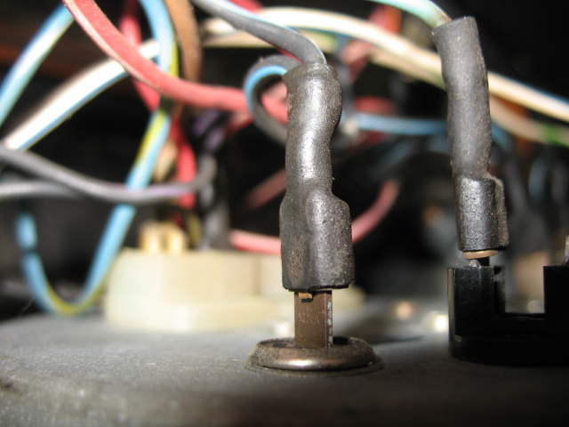

now I am seeing problems everywhere. I pulled a tach out of my 1975 and pulled the speedo out of my v8 and all of a sudden I noticed my drivers side parking light on, I thought I shorted it on, but later realized I have pushed the turn signal stalk downward : ) whew, don't need any more gremlins.
here are some pics of the wires behind the gauges, (IMG:style_emoticons/default/blink.gif)
the pics with wires attached to tach are of my 1975 car, the more dusty ones are of my 1972 v8.
for my v8, I plan to use the tach only for its directional indicators. rarely will I be bumping against redline or needed to monitor redline. street car.
