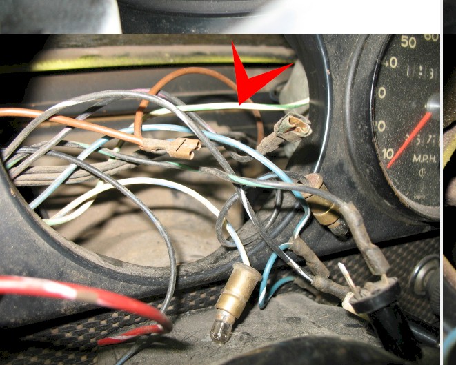

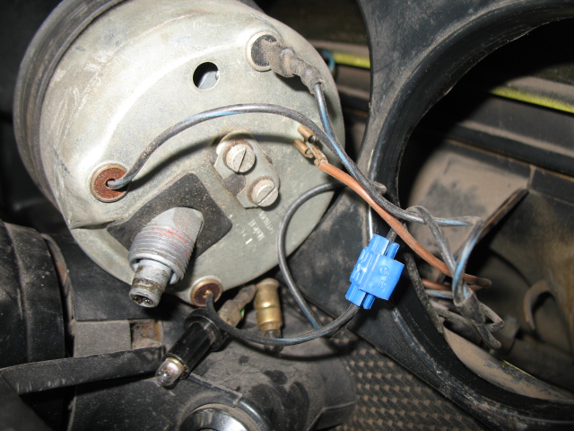

next up - last electrical gremlin - fuel pump/hazard switch issue.
also - trying to determine what this white/green wire is for behind my tach area. UPDATE: tom advised me, in a separate thread, that this WHITE/GREEN wire powers a bulb in the speedo when the parking lights are on. I must have jumped a nearby wire to get power in the past.
