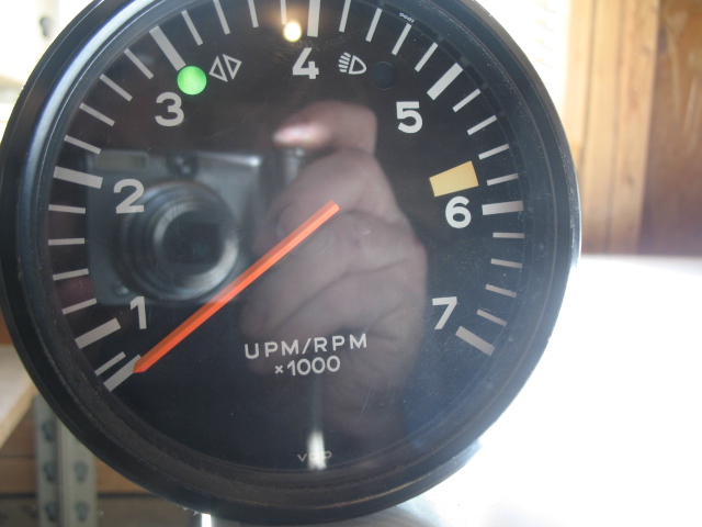

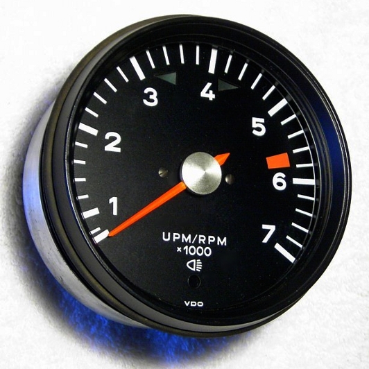

well - later tach won't do.
it only has one green dot for both left and right directionals : (
(IMG:http://www.914world.com/bbs2/uploads/post-104-1381036172.jpg)

jimkelly   spoke - just tested your directionals rewiring - w...   Oct 27 2013, 09:11 AM
jimkelly   well - later tach won't do. it only has one g...   Oct 27 2013, 11:21 AM
Spoke   Yeah, I didn't like the later tach because of ...   Oct 27 2013, 02:53 PM
jimkelly   pretty sure its plastic - but I will put it back i...   Oct 27 2013, 03:44 PM
