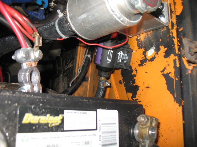

jimkelly   pump in but will probably relocate fuel filter fur...   Nov 7 2013, 11:26 AM
rhodyguy   filter pior to the pump?   Nov 7 2013, 11:28 AM
jimkelly   its after pump. when I had pump higher, I had it ...   Nov 7 2013, 11:36 AM
jimkelly   i had temporarily removed my rear sway bar so I ca...   Nov 8 2013, 12:18 PM
Mike Bellis   From the pics, that looks like a very bad pump loc...   Nov 8 2013, 08:29 PM
jimkelly   I too have smashed my share of hose straps but did...   Nov 8 2013, 08:40 PM
