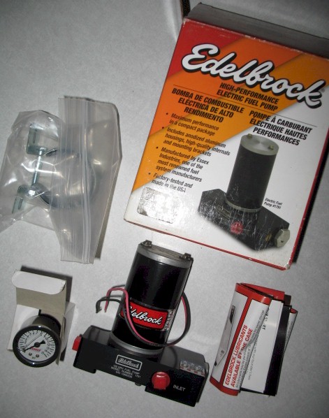

I checked for a clog or other issue, gas all over the place, thought I had it working, but it ran for about 3 minutes and cut off again.
I had a similar pump when I was driving it before, lower mounted. but I do have a nice edlebrook pump and rethinking selling it, and installing it instead, but I'll need some 3/8 npt nipples. and it will allow me to eliminate the one in-line reducer I had to add because the pump I am running now has a 3/8 nipple on one side and 5/8 on the other. maybe I need more line pressure than the POS that I am currently using can provide. though I will look into mounting it lower either way, but I want to avoid upfront as just running the hose was a PIA. a more curved lower tank larger nipple would have been better.
what's funny is the engine was running fine with this pump when I had it feeding from a gas can in my trunk (IMG:style_emoticons/default/blink.gif) thus I do think its height in relation to the gas tank may be an issue.
