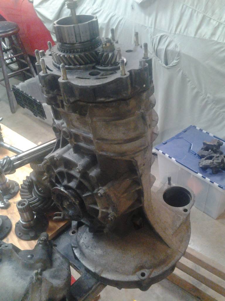

the previous owner used this car as a daily driver till the clutch delaminated. he then removed the motor took the trans appart and well, lost interest.
his mess is now my problem
However it could be worse, its a clean straight car and its got most if not all of its paint on it.
While the trans was apart i took it to my local and trusted trans shop but came back with a bill for 1725 to replace all the bearings and synchros. Ouch.

I know that they have Vw trans in that picture. That case is my 901 case though.
its a side shift as it should be.

QUOTE(colingreene @ Nov 2 2013, 11:53 PM) *
I didn't pay too much attention to the case at first, but I did notice the axles and swing-arm tubes weren't 914. The disassembled case in the pic IS definitely a bug/bus trans. A 901 case has a different throw-out bearing arm arrangement and a vent near the bell housing. Did you remove the drive train?, or was it already out the car when you got it? (IMG:style_emoticons/default/confused24.gif)
Here's a 901 case (minus the nose cone)

Bleyseng   Straight cut cam gears?   Jun 19 2014, 10:09 AM
914_teener   :blink:   Jun 19 2014, 11:56 AM
colingreene   Yes its a straight cut cam gear, I also have dual ...   Jun 19 2014, 05:00 PM
zambezi   It'll be loud. Straight cut gears whine.   Jun 19 2014, 09:36 PM
colingreene   Im aware, I am not super worried about it. I proba...   Jun 19 2014, 09:42 PM
euro911   Im aware, I am not super worried about it. I proba...   Jun 19 2014, 11:53 PM
colingreene   Thats seriously bad ass. Sorry about the skunk pro...   Jun 20 2014, 10:59 AM

euro911   Original MCs were ATE with a 17mm bore. Getting a ...   Sep 11 2014, 09:32 AM
colingreene   I was told this was a 19? I dont know for sure tho...   Sep 11 2014, 09:48 AM
Dave_Darling   Look around on it for numbers. There should be a ...   Sep 11 2014, 04:20 PM
colingreene   Ah neat thanks, ill have a look at it tomorrow.   Sep 11 2014, 10:21 PM
