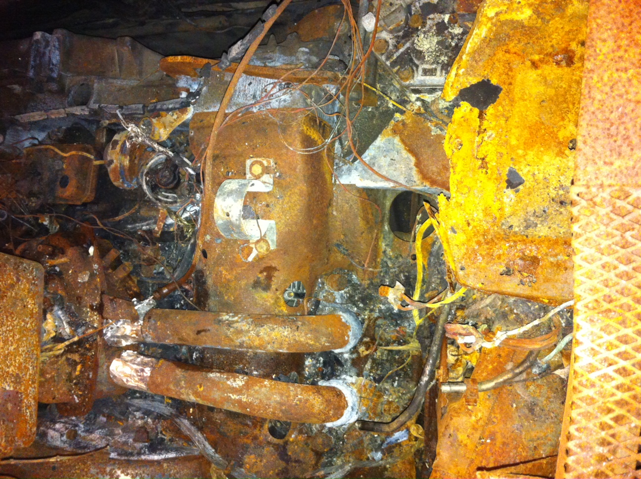

I don't think the correct question was asked.. I should be how much will it cost if I don't change my fuel lines?
This wasn't from a tunnel rupture. Maybe from an injector hose or something but in this case it cost a car with a solid chassis. (IMG:style_emoticons/default/sad.gif)
