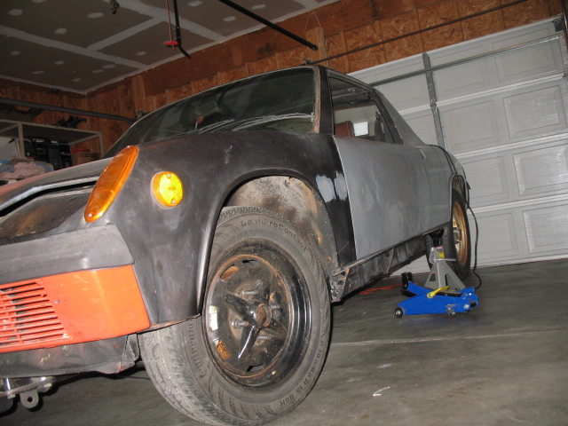

> making some progress on my sbc 307 V8 car, -- rear sway bar back in

wiring my v8
and tell me what I have wrong or missing.
my bad for never labeling the wires (IMG:style_emoticons/default/headbang.gif)
distributor is msd 8360
but you guys are smart (IMG:style_emoticons/default/smoke.gif)
and yes - I better connect that oil guage line or I will have a mess on my hands.
