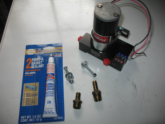

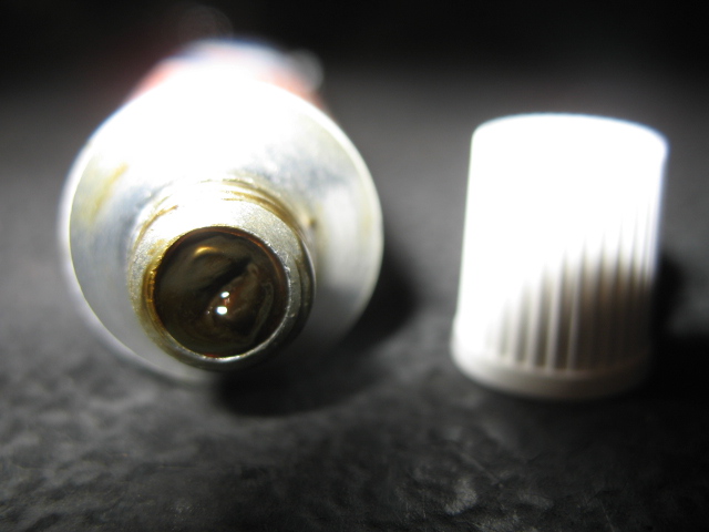

thanks guys for the comments on the permatex product!
just returned from napa where I got a small tube of permatex form-a-gasket sealant, and from ace where I got some hardware to mount my edelbrock pump. waiting on a delivery from ebay of some heat shrink 1/8 ID and 1/4 ID as I ran completely out. this time I got 3:1 ratio heat shrink with adhesive center, I think the stuff I just ran out of was 2:1 and did not have a juicy adhesive center either.
I should have been expecting this stuff to be DARK color, keep it away from your wife's kitchen towels : )
two guys mostly work at my local napa, a nice guy about 55, and a young tobacco chewing, slow moving, could give a shit, punk. yesterday I got the older guy and I asked him about the stuff vs permatex's thread sealant. he said he used Teflon tape for years with no problems. just like internet threads say when you search what to use on npt threads with fuel. the form-a gasket was a buck cheaper, so I went with it.
