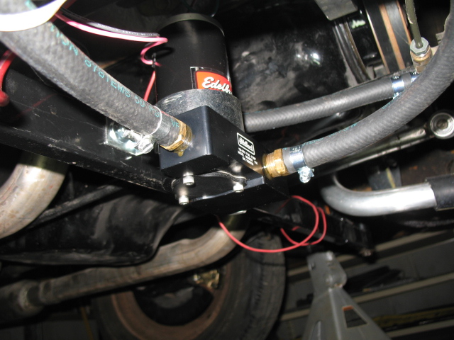

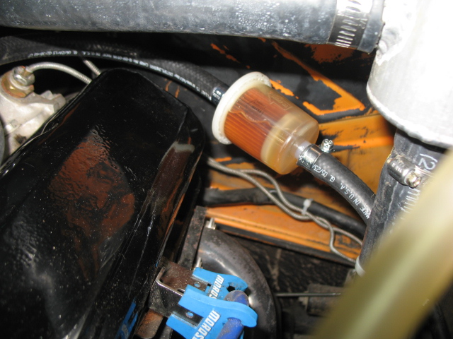

post Nov 7 2013, 11:26 AM
Delaware USA
Posts: 4,969
Joined: 5-August 04
From: Delaware, USA
Member No.: 2,460
pump in but will probably relocate fuel filter further down, away from header, later on.
is it ok for fuel filter to be horizontal, like I have it, or should it be vertical?
the fuel pump inlet is a good 2+ inches below the fuel line coming out of the firewall but the pump bottom is 1 inch below the engine bar, I will probably need to raise it to at least flush with bottom of engine bar.

jimkelly   pump in but will probably relocate fuel filter fur...   Nov 7 2013, 11:26 AM
rhodyguy   filter pior to the pump?   Nov 7 2013, 11:28 AM
jimkelly   its after pump. when I had pump higher, I had it ...   Nov 7 2013, 11:36 AM
jimkelly   i had temporarily removed my rear sway bar so I ca...   Nov 8 2013, 12:18 PM
Mike Bellis   From the pics, that looks like a very bad pump loc...   Nov 8 2013, 08:29 PM
jimkelly   I too have smashed my share of hose straps but did...   Nov 8 2013, 08:40 PM
