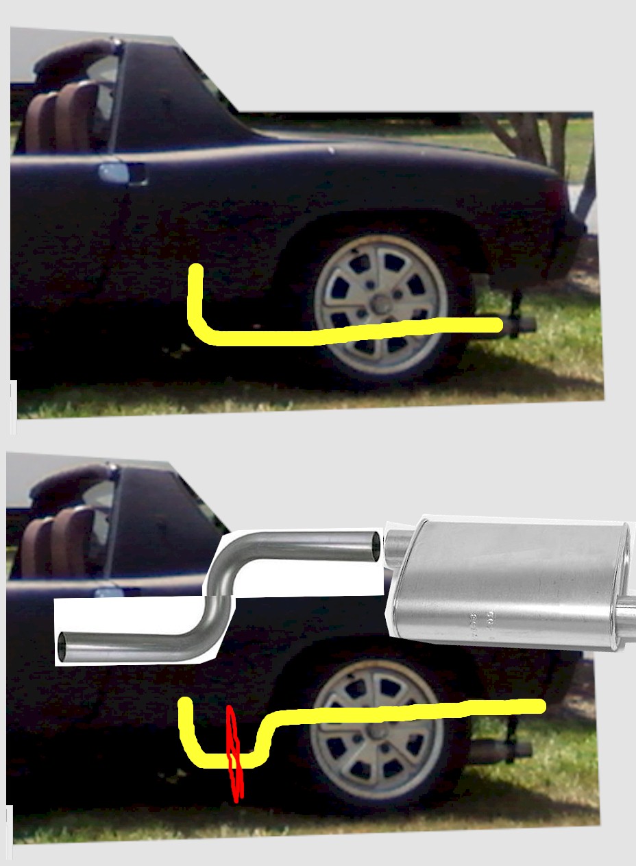

and how I plan to change up my exhaust, to get it quieter and to get it higher off the ground at the tailpipe, too noisey for neighbors and I scrap my tail pipes too much.
gonna keep it dual, for the annoying drone, and it may be helpful when I get it tuned as both sides of engine can be checked independently with a sniffer.
